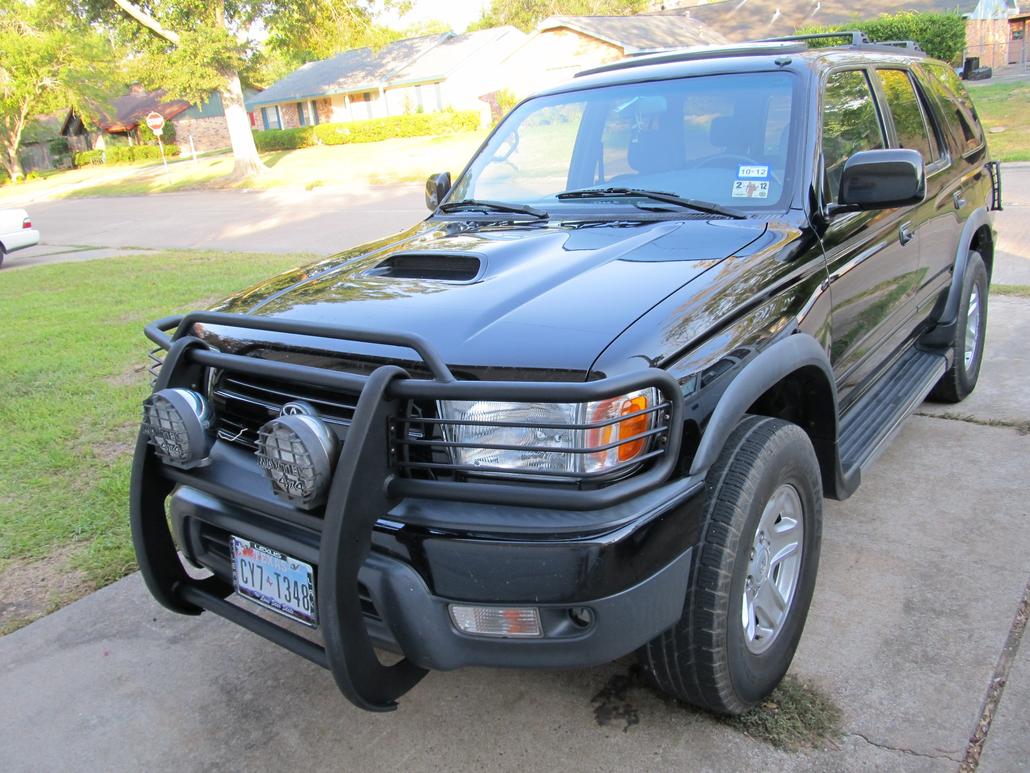

So i finally got my brush guard and lights! ....now i gotta wire the lights.
i was planning on running a ground wire and a hot wire and rigging it to a toggle switch on the dash.
would anyone be so kind as to show me directions on how to properly install all this awesomeness!? i have a basic idea and figure i could do it on my own but i would rather be safe than sorry.
