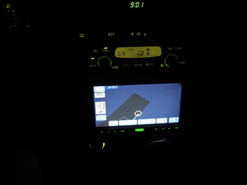

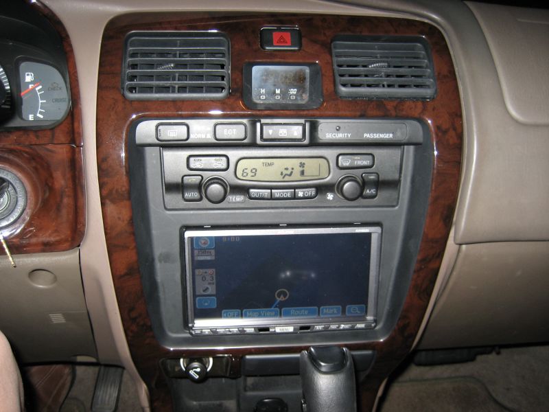

Picked up a Eclipse AVN6620 from 4runner19 and it was a real simple install, mostly plug and play. I mounted the GPS antenna under the dash on top of the vents and so far no issues with signal reception for the most part.
I went ahead and ran the speed and reverse lines to the cluster, so that added another 20 minutes. I think the hardest part for that was that in everything I read, the reverse signal wire was red with a yellow stripe, it was a different color, White with a light blue stripe I believe (pin 3 of connector 3).
Here are some pix.

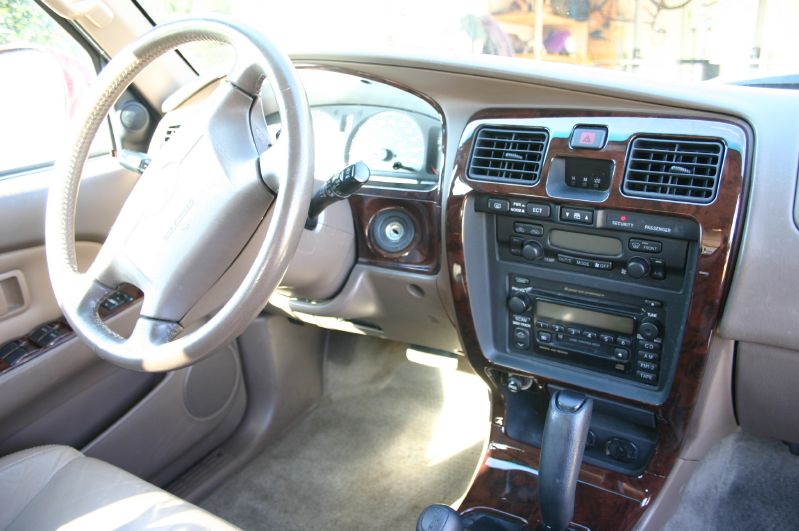

Before:
After:

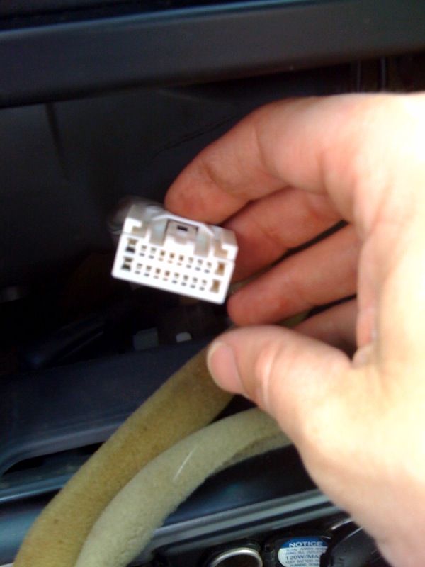

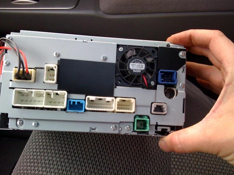

So-the AVN6620 arrived today (thanks 4runner19!). I took the dash apart and found that the plug I pulled from the factory stereo will NOT connect with the Eclipse system...I thought it was a direct plug in, right? I also have an extra plug that I cannot connect to the eclipse. I didn't have alot of time this afternoon so I put the dash back together to go to work for a few hours. Hoping someone can offer me a suggestion and I can fix it tonite. Do I need an adaptor? Didn't even get to the speed sensor, gps, or e-brake wiring :(
Hope the pictures give some insight.....

Realized that I needed to remove the external amp below my factory stereo.(thanks Ptam). Unit is in and working for now-will be pulling apart tonight to install gps antenna and try to figure out the 3 remaining wires for speed and parking brake. Will post pics.

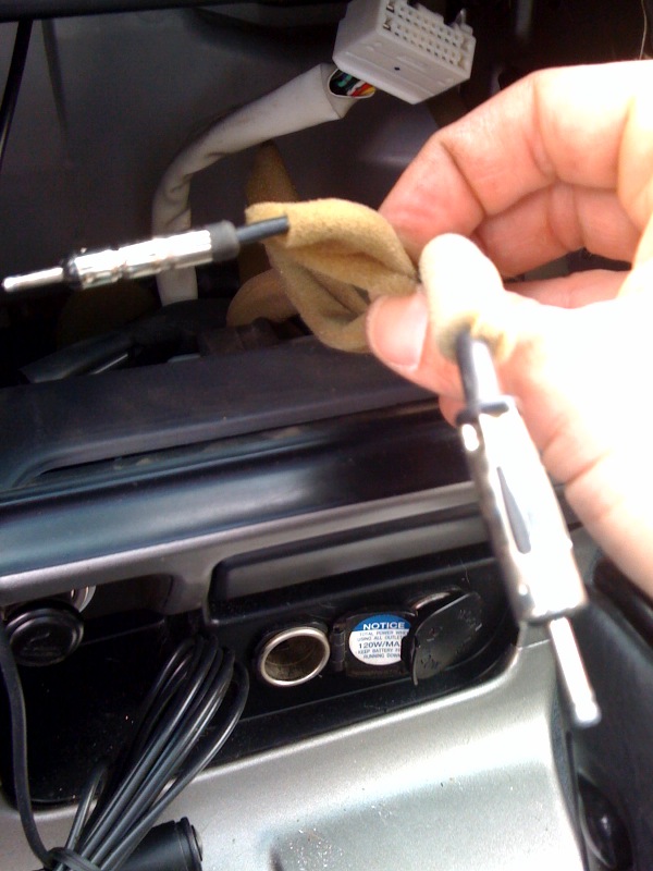

Running into trouble: Eclipse AVN6620 Unit is installed, gps antenna connected but not able to figure out where reverse wire, speed wire, and park wire are supposed to connect. Also, for whatever reason, I lost my parking lights, license plate lights, and all dash lights except for the head unit. I know the problem is my inexperience behind my stereo, but cannot figure out why all the lights don't work. Process of elimination leads me to believe the 1 plug that was in the back of the factory stereo that has no place on the eclipse is the one to close the circuit for those lights (circled in red in picture). Either that or one of the screws that held the external amp in place needs to be replaced? ANY suggestions are appreciated-would be happy to get my lights back, let alone the other wires connected.

Thanks-I'll tackle the cluster over the weekend. I'm going to have to reinstall the screws from the external amp and ground the park wire. Do you see any reason why that 1 prong plug would cause a problem unconnected in the back? I'm almost finished-just can't get my dash, cluster, parking and license plate lights back on. :violin:
That plug is actually the diversity antenna (secondary), so it really wouldn't be related to your lights at all.
