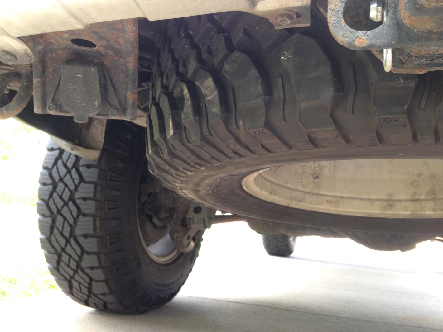

They have to be very similar tires to not risk damage on dry pavement. What I did was just go to a used tire shop and find one similar, with similar wear, since mine didn't come with a matching 265/70/17 spare. Cost me $50 total. To have a match. That being said, I'm not sure if that larger tire size will fit in the spare location. Mine barely fits as is.
Same. My 255/75/17 barely fits too. (same approx OD as the 265-70-17). The example in my photo is a 255/75/17 BFGoodrich Mud Terrain like from a stock Wrangler Rubicon. *The tight spot is actually closest to where the tire would meet the hitch, not the box shown.*
