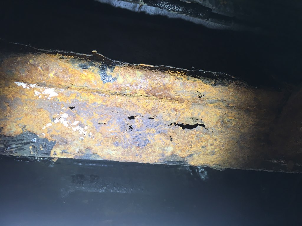

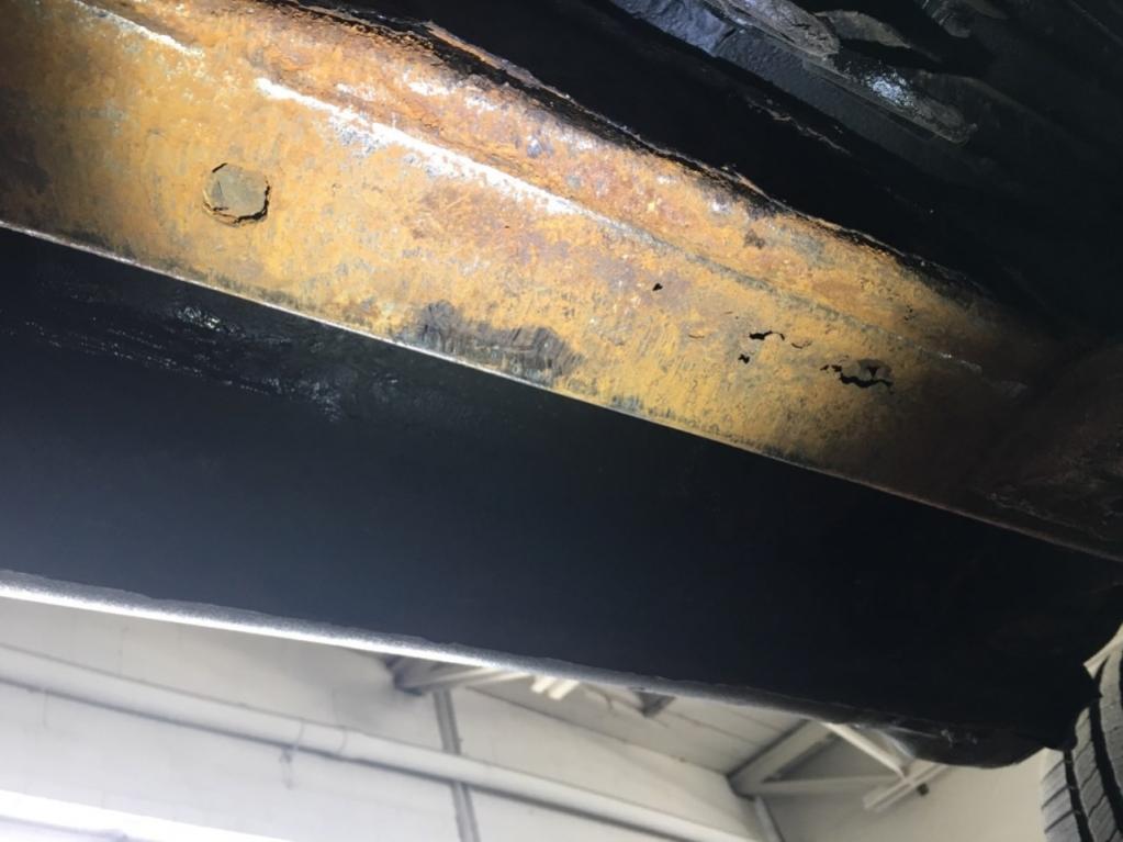

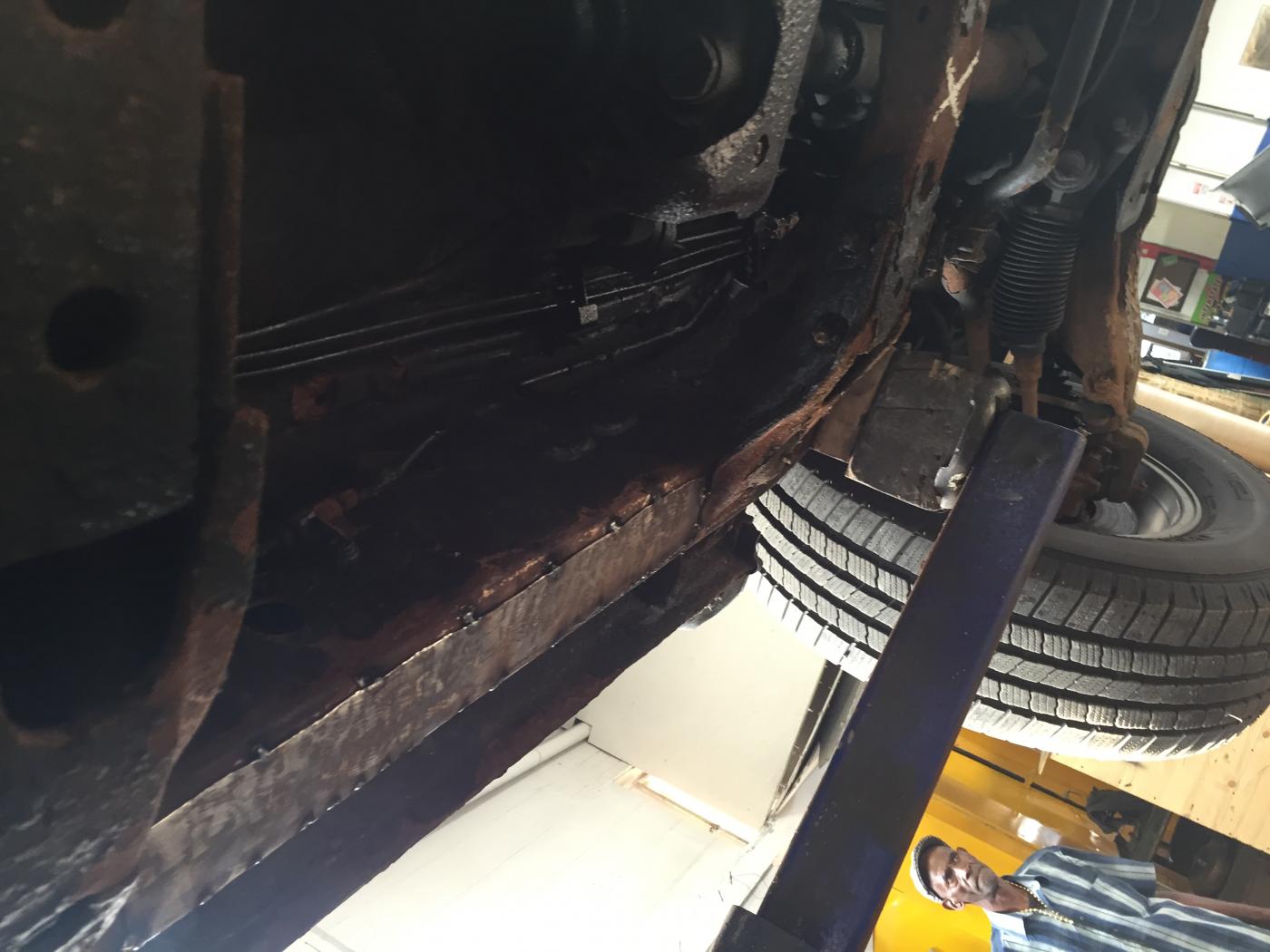

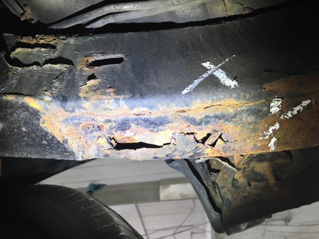

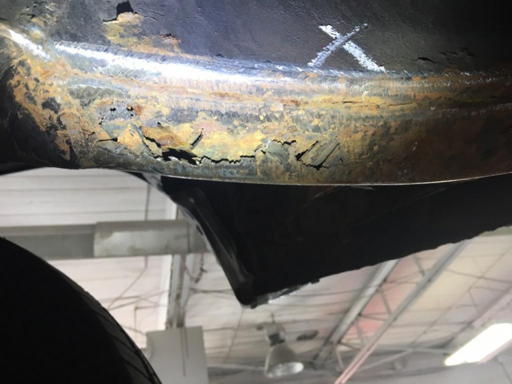

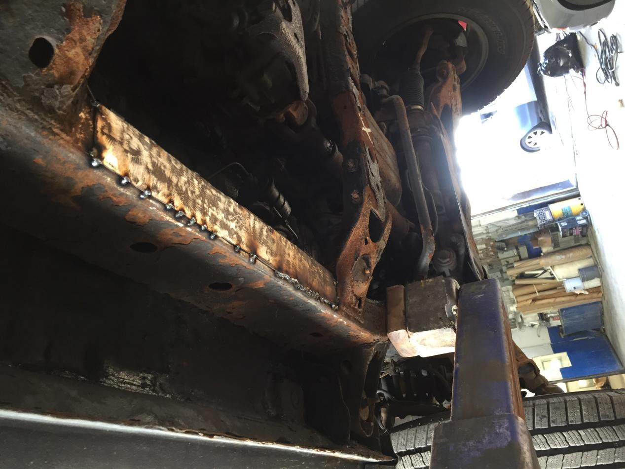

Well in all fairness these trucks did come with a decent rust proofing from the factory. If you think about it it's extremely rare to see Rot on inner fender wheel wells or body rust around the fenders because of the way they're sealed up. More commonly I see rust forming around windows from drainage from the rubber seals. My dads runner is like the rust eze guys on the first cars movie however. But that vehicle has never left the state of Michigan and people out here really dont take care of the vehicles they call their "winter beaters" as I'm sure his was for many people here. I honestly thing better drainage would have been more effective than further rustproofing. The guy that welded my frame sprayed rubber on it without asking me and it kinda pissed me off because now I've got to strip all of that off and paint with POR-15. He better have done a good job on it and not just tried to cover up shotty work. It does look good though so well see.
I hear you the front left and right of my frame has rust. Had to get a shop to cut out the rust. They did a great job. Did the same thing 5 years ago with the middle right and left side interior of the frame and it’s still solid. Rust doesn’t have to end the life of a vehicle. Especially if you are thinking of how much money a different car would cost.

I have 5 3rd Gens and live in the rust belt. I have been experimenting for years on how to not only strengthen these frames, but seal them while fixing the rot in the frames.
The best way I have found so far (though very time consuming) is to cut the bottom of the frame out (as you can then easily see what the inside frame clean it out) and plate the inside of the frame by grinding slits where your plates meet and welding it all back together. I even paint the plates. Then before resealing the bottom back up using 1/8 plate as well I give it a major heavy coat of fluid film inside the frame. This way you hide almost all of your work, and can grind the outside welds smooth. Repaint the frame and fluid film it again.. By removing all the frame holes, this seals the frame from dirt. I use 1/8 in plate. This basically gives a u frame within the frame to weld new body mounts on etc.
OP, the repair job looks great! Its always nice to see people spending the time and money to patch versus letting it get so bad that a frame finds a new home in the yard. Enjoy the next who-knows-how-many hundred thousand miles on this frame :rockon:
