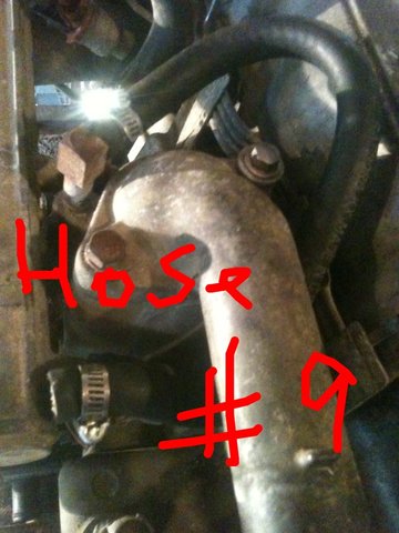

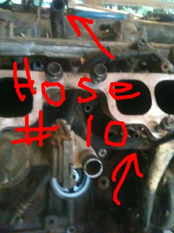

I'm in the middle of a rebuild on my 22RE. And I don't know about you guys, but me very much likie pictures for when I go to put it all back together. Better yet, I like taking notes on my pictures. So I downloaded an iPhone app called "InstaEditor"....
Here's how it works. You open the app, take a photo (or choose an existing photo out of your library), and edit it any way you like. Then, when you're finished, the app automatically saves the edited photo into your library.
Below are a couple of examples. After taking these photos and writing notes on them, I was able to remove the hose(s), label them with a piece of tape and a sharpie, and toss them in my parts box.
Again, I know that a lot of you probably already do something similar, but this process is making things a lot easier for me. Plus, drawing on photos kind of makes me feel like Bob Ross......"Happy hose...." :artist2:
