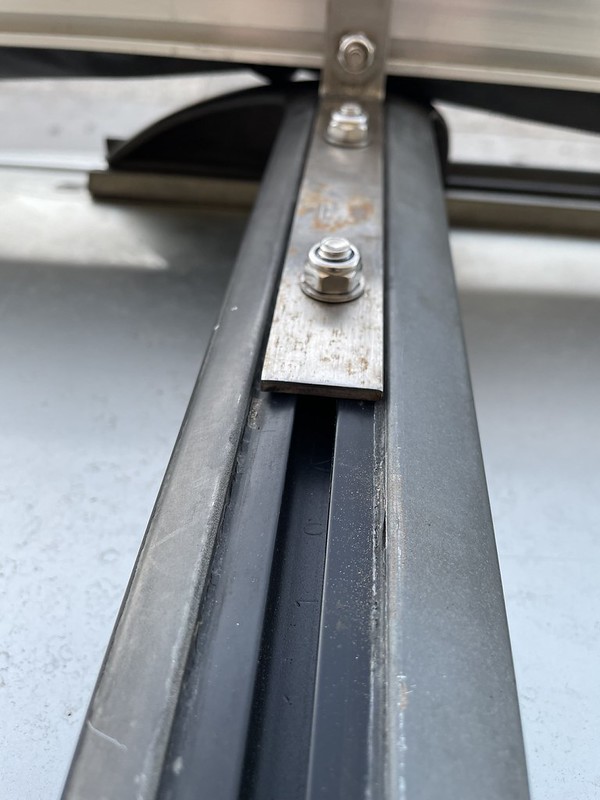

I have a knock off awning and i just drilled 4 holes through the bars and added washers top and bottom. I have had no issues with it since i put it up there several months go.

if you take the Load bars off. un screw and remove the ends you can take the rubber out and there is a channel that you can use to slide a t bolt into and mount those simple L brackets on.
I used an piece that I had left over from a RTT mounting system. flat aluminum piece that had a little indent for holding the bolt head from spinning.
I then trimmed the rubber to fit.

I actually made my own out of spare parts I had from a roof top tent. They were the aluminum channel slide guys... (don't know what they are called.) had to grind them down to make them fit. nice part is they have a notch that holds the bolt head from spinning.
