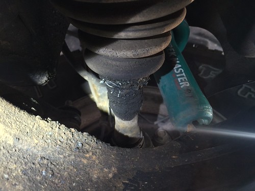

While draining my radiator I noticed a grease and crud build-up on my front driver's shaft. I'll accept the boot needs replacing, but are there any signs to determine whether the entire axle shaft needs replacing? AND if I replace one axle shaft and boot, should I replace both for reasons someone is willing to explain? I've spent a lot of money this winter replacing parts that turned out to be good as new because I was told it's best to do so before I started wrenching.

Not the best photo I know.
Just replace it with a new one from NAPA or wherever for $90. Cleaning out the grease for the reboot kit is a massive pain in the ass. I don't know any reason to replace both if only one is leaking.
If you have the OEM CV axles still on your rig, I'd keep them and reboot them. Yes, it's some work to reboot the axles but it's worth it. Our OEM axles are superior to anything an auto parts store is going to sell you.
If I were you, I'd just reboot both sides because you know the other side is probably going to go soon too. Reboot kits cost around $50/each.
