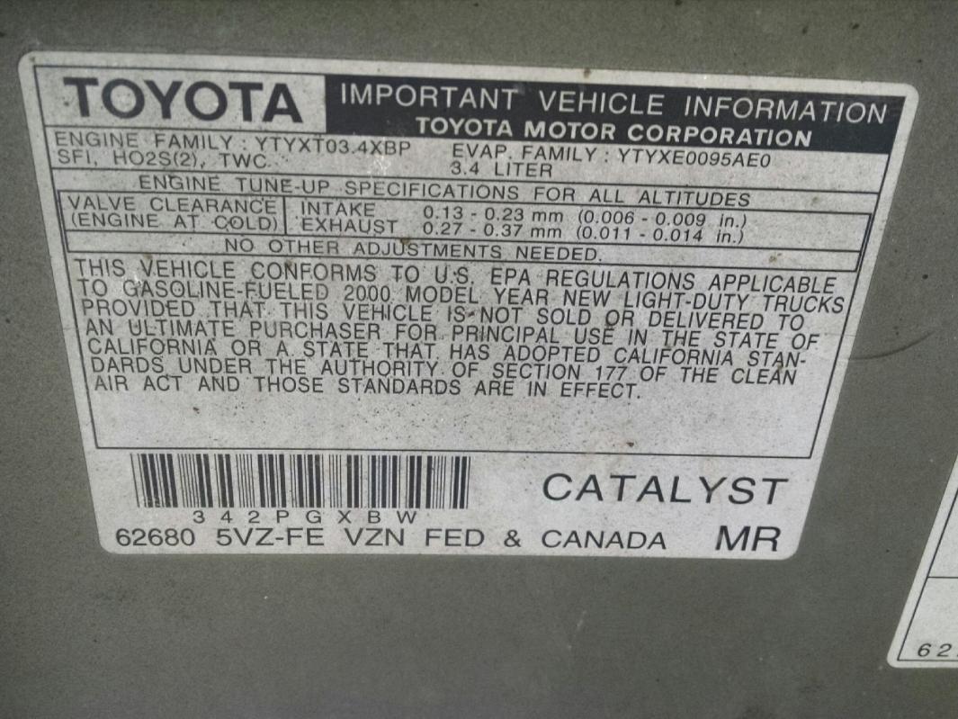

This is the sticker in the engine bay. Says does not pass CA emissions. But maybe someone knows better than me?

No No No. That applies to NEW cars, so folks won't run over to Vegas to buy cars cheaper.
A 49 state car like the one you are describing (and like mine, also from AZ) will be tested in California---tested to meet it's native 49 state standard.
Unless the CA rules have changed since June (ha ha), when I last smogged my 1997 4runner which was bought new at camelback Toyota in Phoenix in 1997.
If you look at the prospective 4Runner, make sure that all the underhood electric and smog control connections look kosher, that is: Not cut, hacked, bandaided, rerouted, etc.
Drive it a hundred miles right before you get the smog test.

That's not what the sticker means. I have a federal emissions 4Runner as well and it has passed smog each time (except for when I tried it with the deckplate mod, that one is not allowed).

Edit: I just found this e-mail from CARB. I had asked them about what is considered a "new vehicle" brought in from out of state and smog requirements.
The sticker that you provided by the owner, only applies to the first owner aka the ultimate purchaser of the vehicle. Meaning, the first person to buy this vehicle brand new, cannot be a california resident or live in a state that adopts the California emissions law (section 177). So in theory, the vehicle you're looking at CAN be registered in the State of CA as long as it passes Federal EPA emissions requirements.
Subject: 49 state vehicles
Apr 17, 2018,
"Hello,
If a vehicle being purchased out of state has less than 7500 miles at time of purchase, then it is considered new and needs to meet CA emission standards.
If the vehicle being purchased out of state has more than 7500 miles, it is considered used and must meet at least federal emissions standards.
Thank you."
I purchased a used 5th gen at a dealership in Phoenix this year and brought it back to CA. This is how it works.
1. The vehicle MAY be compliant with CARB emissions. You have to check the sticker under the hood.
2. If it is not, it needs to meet federal emission standards.
Probably best to smog before you take the title to the DMV to transfer the title. They will do a VIN verification (a DMV employee will walk out to the vehicle with you and inspect the VIN on the dash, door, hood, engine (i don't remember if they did this on mine) and check the mileage on the odometer. Once that is done, you'll get CA plates and registration. Make sure to have the Arizona title or last registration card from the previous owner.
