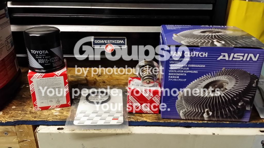

So new Radiator in, all topped off, took it for a few short drives and temp. still reading 203*. Did the newspaper test on the cooling fan and it stops it easily......so new Aisin fan Clutch on the way, new Toyota thermostat on the way also. More work for me but I want a solid truck.

Temps where reading 203* but solid. I replaced the radiator and put in fresh coolant. Wanted to protect against pink milkshake anyway. Still 203*.
Put the fan clutch in after old one seemed like it wasn't doing its job. Still 203*
Drained radiator, installed new thermostat according to a well written DIY. Filled up with another almost 2.5 gallons of Zerex Asian. Temps solid around 188-190* with AC on full blast just idling in driveway after a 10 min drive. Awesome!

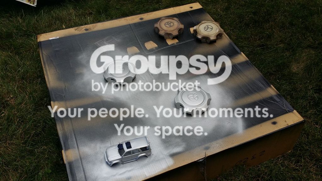

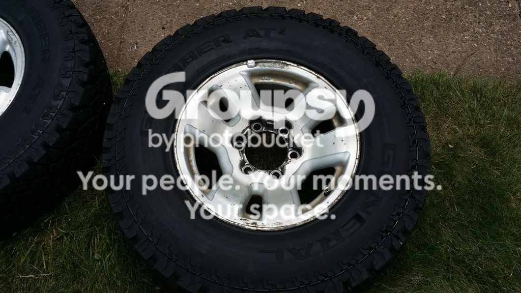

Had to do something with the wheels. I used Duplicolor wheel paint before and it's pretty sturdy. Here is my daughter helping clean before I pulled them off.
20150702_135016_zps4p5tp5nx.jpg~original
before pic:
20150702_123822_zpsqaunbafq.jpg~original

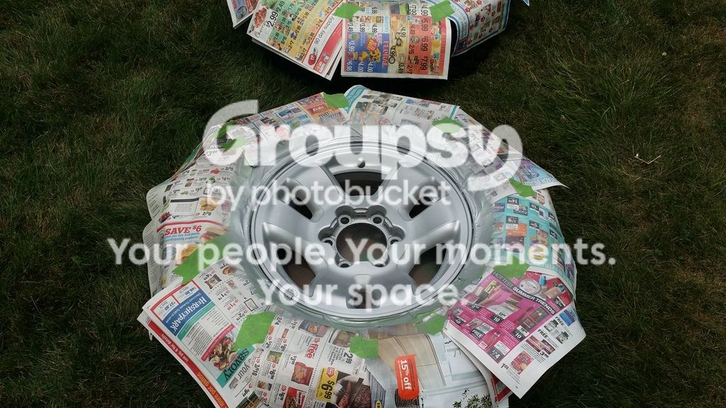

during pics:
20150702_135550_zpsxdhjvsgu.jpg~original
20150702_135539_zpsq2vaerqf.jpg~original

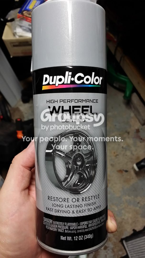

^^^^^The wheels look great! What are the specifics on the wheel paint? Looks very close to factory. My wheels are looking pretty junky and could use a refresh.
20150703_205337_zps3pyms2t4.jpg~original
A little metallic sparkle to them. Disregard the pic on the can, it comes out just like the cap. I like a brighter wheel with black. They do offer a matte black and gun metal, at least those where the two others I saw.

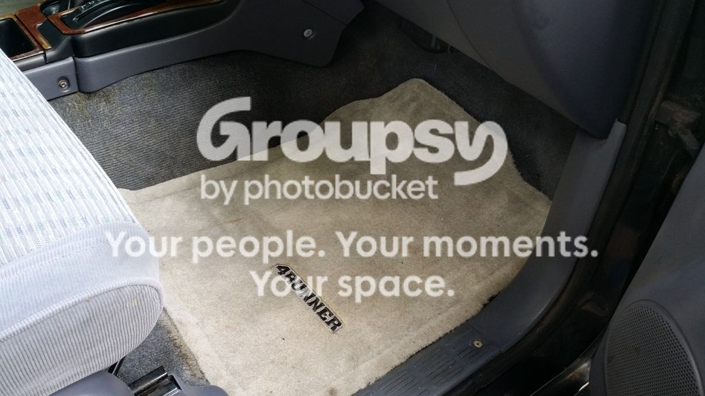

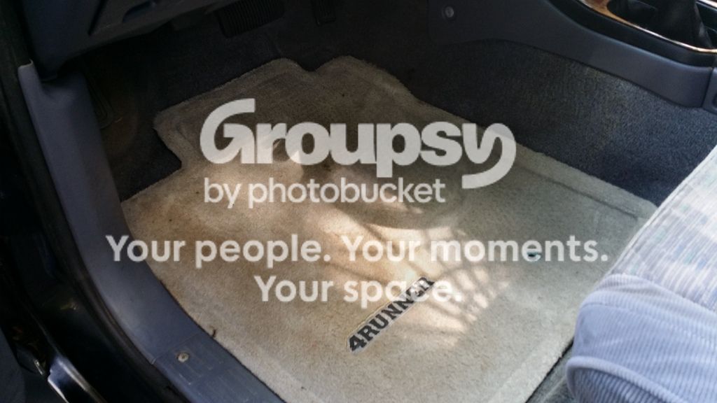

So if your in a pinch for floor mats, your cheap, and you just happen to have a set of 4th gen mats in your garage.....
20150721_150005_zpskguujmbk.jpg~original
20150721_145946_zpswyarpjij.jpg~original
They fit great! That'll get me by until I want to spend $ on something nicer. I just cleaned them up a little. So a little better then the pic.
