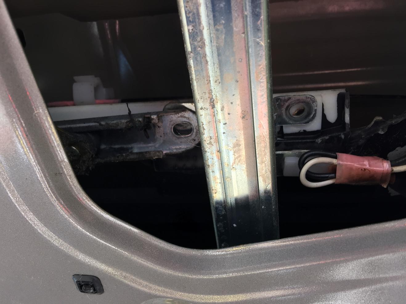

Maybe it's not aligned in its track correctly so that clicking/popping noise is the glass clicking back into its guide... There are 2 guides on either side and the drivers side is some crumby plastic slide not even a wheel!! I'm sure dirt and grime build up in there. Again I don't know that this is a solution, just something to explore
When mine did this, i discovered that the lock tumbler was getting hung up in the window track. The tumbler is only held in by plastic tabs. Might look into that. I ended up just removing mine and sealing the hole with a rubber plug.
