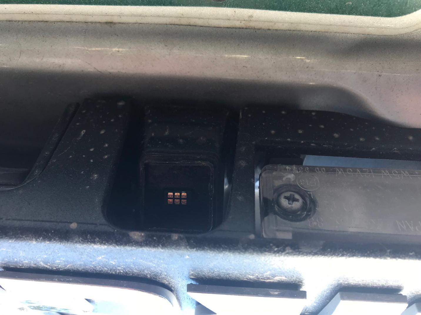

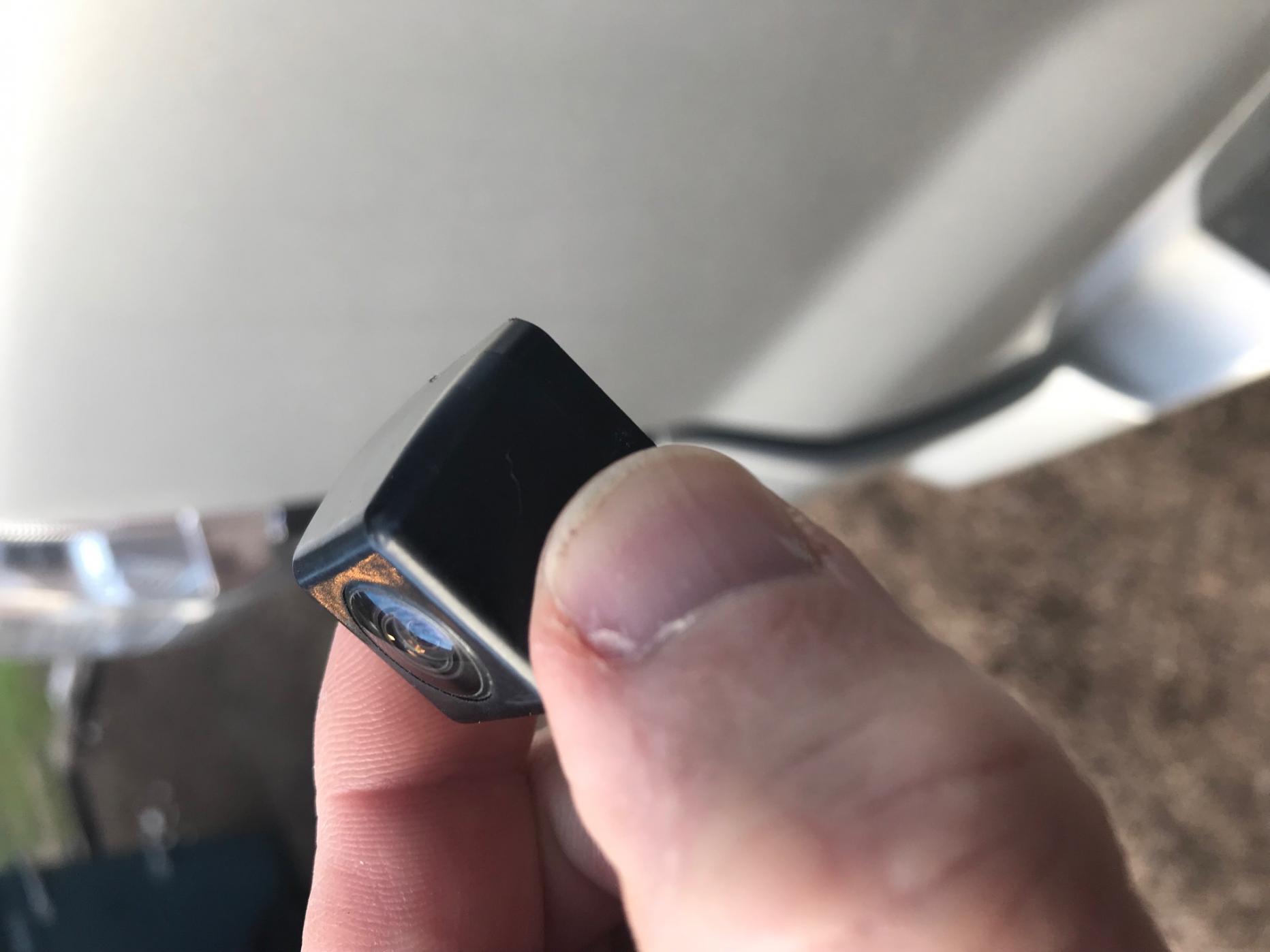

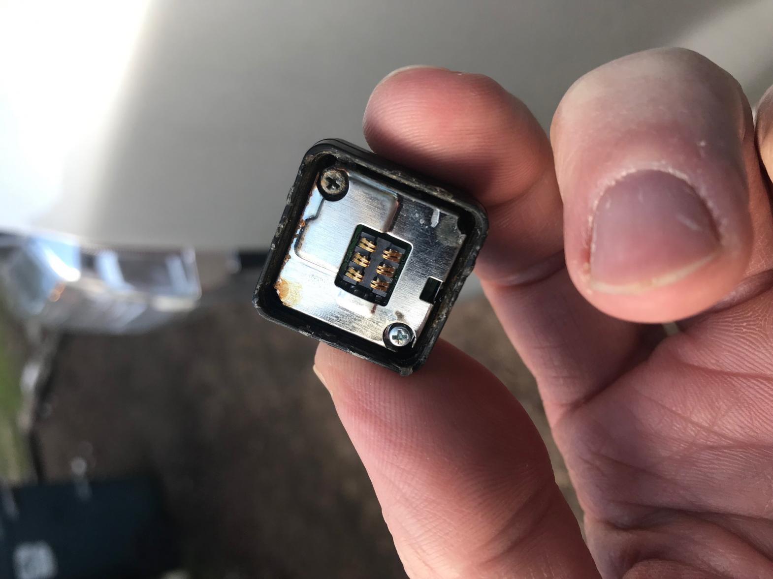

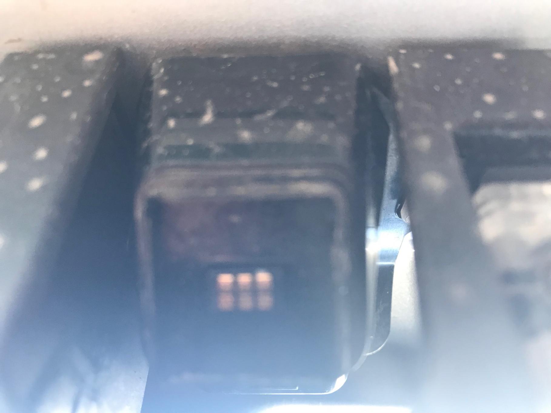

I removed the interior panel and from the inside I was able to massage the dent to improve the way it looks quite a bit. However, as I was tapping on this from the inside of the liftgate, the outer piece of the backup camera popped off (see photos). When I was done with everything else I pressed this piece back on but now i get no picture. I tried rotating it 180-degrees (the 6 tabs/pins only line up the one way) and still no picture. I asked at the dealer if there was something that needs reset and I was told that they would have to replace the camera, at around $750 (not happening).

If you tape the camera in place firmly, does it still work?
Maybe you are not making full contact with the pads?
are any of the little spring like pins bent, or flatter than the others?
It doesn't look like any of the little tabs are bent any more or less than all of the others. Also, when I put it back in place and press it on it seems to be on there pretty solidly, just no picture on the screen...
You mentioned doing some bodywork from behind after taking off the interior panel. Any chance the wire harness got disconnected/damaged. I know it's like phone support asking you if it's plugged in, but... I've had that whole garnish, along with the camera, door latch, and lights off. I could see how something might get missed.
I’m fairly certain there was no damage done to any of the wiring, but if all else fails I could pull the panel again this weekend and double check. Good idea
