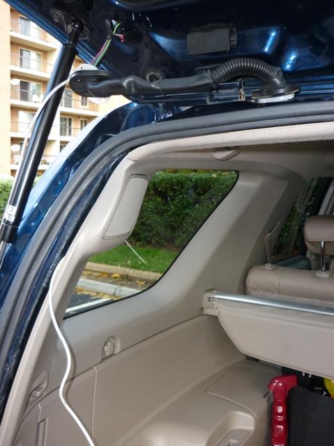

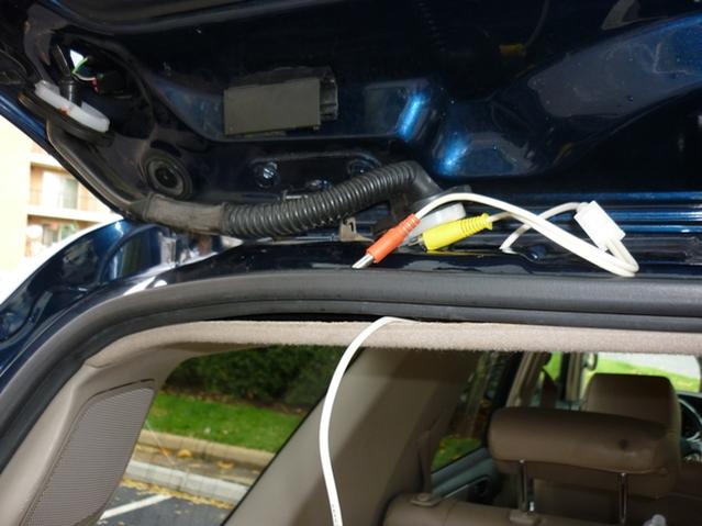

I was going to do a write-up but got interrupted on the install (winter came). I have a couple of pictures though that might help. I fed the wiring from the HU along the drivers side up to the gate.

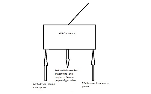

I just picked up a CMOS-200, as well, and will be hooking it up to display through my Pioneer AVIC-X920BT. My question is:
Did you hook up using the purple trigger wire to turn on the camera? I'd like to have the option of turning the camera on anytime, while retaining the auto-on for Reverse.
My thought was to add an ON-ON switch -- on one side of the switch, I would connect to an ACC/ON powered 12v source; the other side would be connected to the Reverse-activated 12v source (Red/Yellow wire). The center connection (COMMON) of the switch would go to the trigger wire on the Nav unit/monitor.
The CMOS-200 manual states that if your Nav unit has a dedicated input, you don't need to use the purple wire. Does this mean that I don't need to hook up the purple wire, and it will somehow sense the input being active on the Nav unit and turn the camera on??
I've drawn below what I had in mind.
If the camera doesn't automatically turn on when the Nav unit switches to Reverse view, I guess my other option would be to also hook up the purple wire to the center connection of the switch, and turn it on at the same time as the Nav unit reverse view...
Thanks in advance for any help you can provide regarding how this unit works!

I put mine there but didn't get any good pictures. The biggest mistake I made was trying to get the camera wiring through the factory wire housing between the body and the gate with the connectors still attached. They will almost make it but it's a nightmare and in the end, mine ripped off the wire. Save yourself some time and just cut them off so you're only fishing the wire through.
I used a brand new spade bit to cut the plastic at the factory mounting location. Then I use a tiny bit to get the corners, followed by a file to square the hole. It went pretty fast.
The license holder ( garnish in Toyota speak) comes off easily. Once you pop off the rear gate interior cover, it's 4 nuts (I think - can't remember if you have to remove the lock) and then pops off (there are a couple of plastic clips that still hold it after you remove the nuts).
