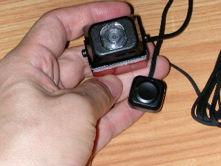

The Eclipse BEC103 camera is a direct plug and play model, but difficule to find and price a little higher.

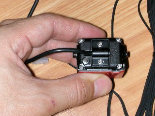

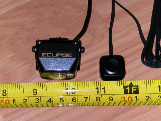

Here are some pics of Eclipse BEC103 camera on my Sienna.
I believe one of the 4Runner owners got one and mounted under the spoiler.

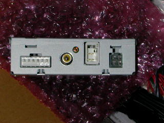

This is the power/control module for +12VDC input. The camera itself operates on +6VDC. You won't need to use this if you have an Eclipse headunit OR Toyota Headunit.
The button is to activate the camera when not in reverse IF you're using the power/control module.
3rd socket from the left is where the camera plugs.
I just have my camera plugged directly into the back of my Solara NAV.

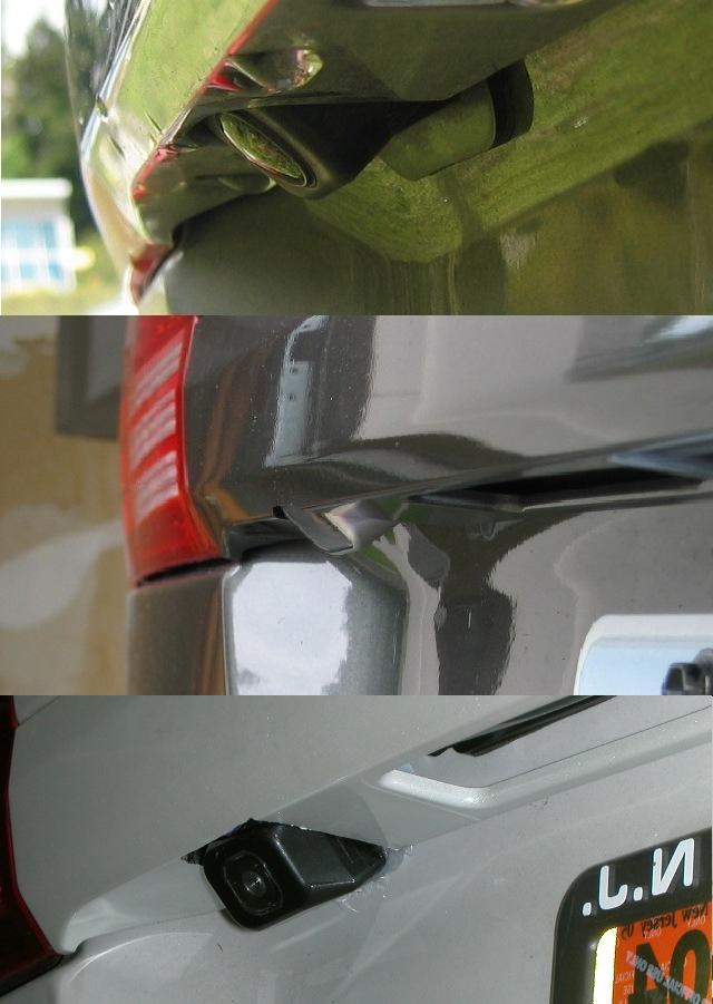

This is for comparison..
Top : stock Sienna Camera which is mounted on the trim but through the hatch
Middle : SAVV camera mounted and through the hatch
Bottom : Eclipse mounted ON the hatch
I didn't use the mounting bracket to mount it to save some space. Just 3M chaulking sillicone.
