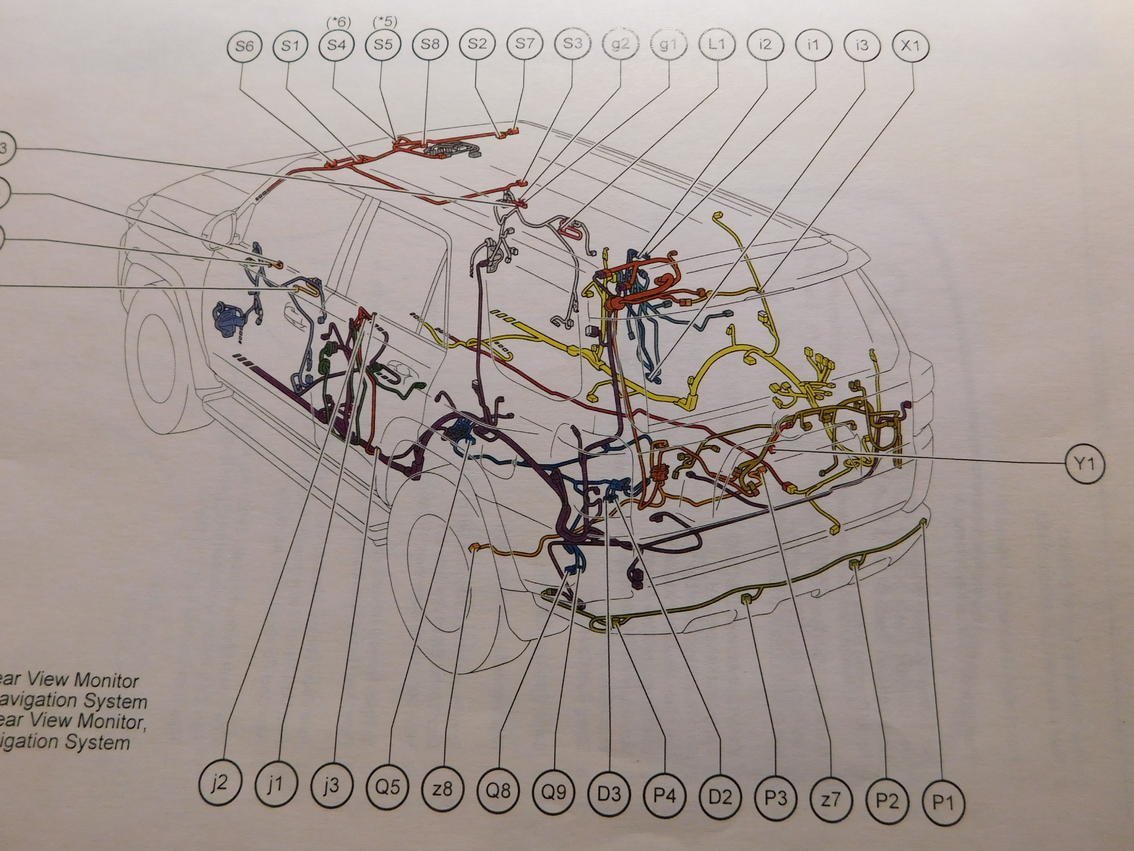

Let me spend some time looking at the wiring diagrams- they are 2010 but should apply...There are sections that show wiring locations/routing within the body.
I have them in a book so it's easier to follow. Gimme a minute or two...
You...are awesome. Thanks!

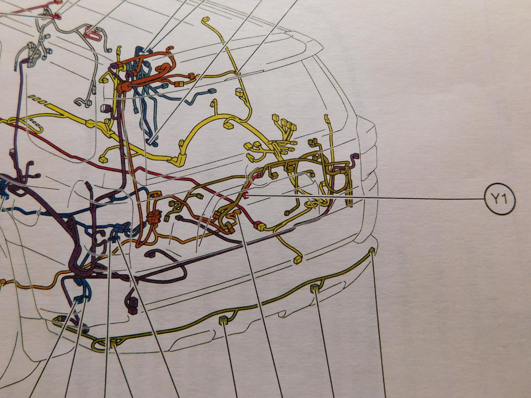

OK- I remembered correctly!

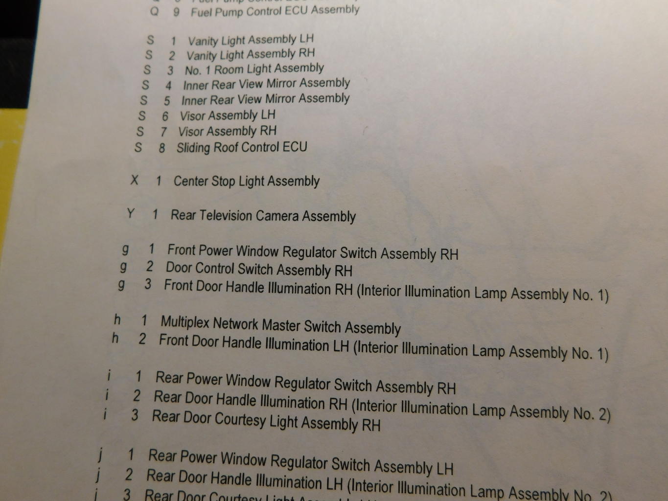

Y1 is the camera connector.
You can see here the wiring from the camera (red). Connects to the dark yellow harness. That snakes around and across the hatch and connects to the dark orange harness. Orange heads up driver's rear pillar and through that rubber boot into the headliner and connects to the purple harness. Purple harness goes down driver's tail light area then through sill plates all the way up front.
Obviously the "real" harnesses aren't colored, lol.
That should get you going...

Note it's Y2 on the 2015+, I was looking it up on AllData. The schematic looks very similar however for 2015+ however. I concur with your observations.
