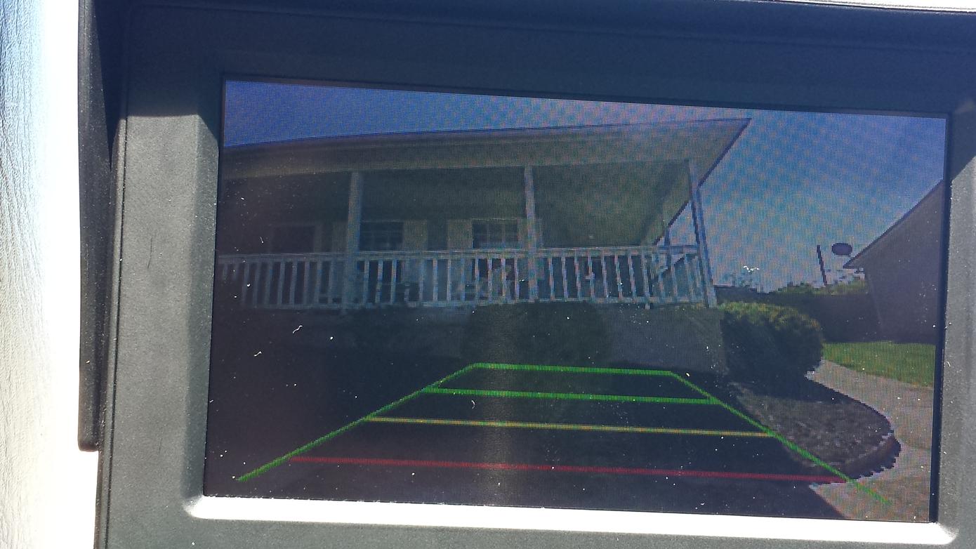

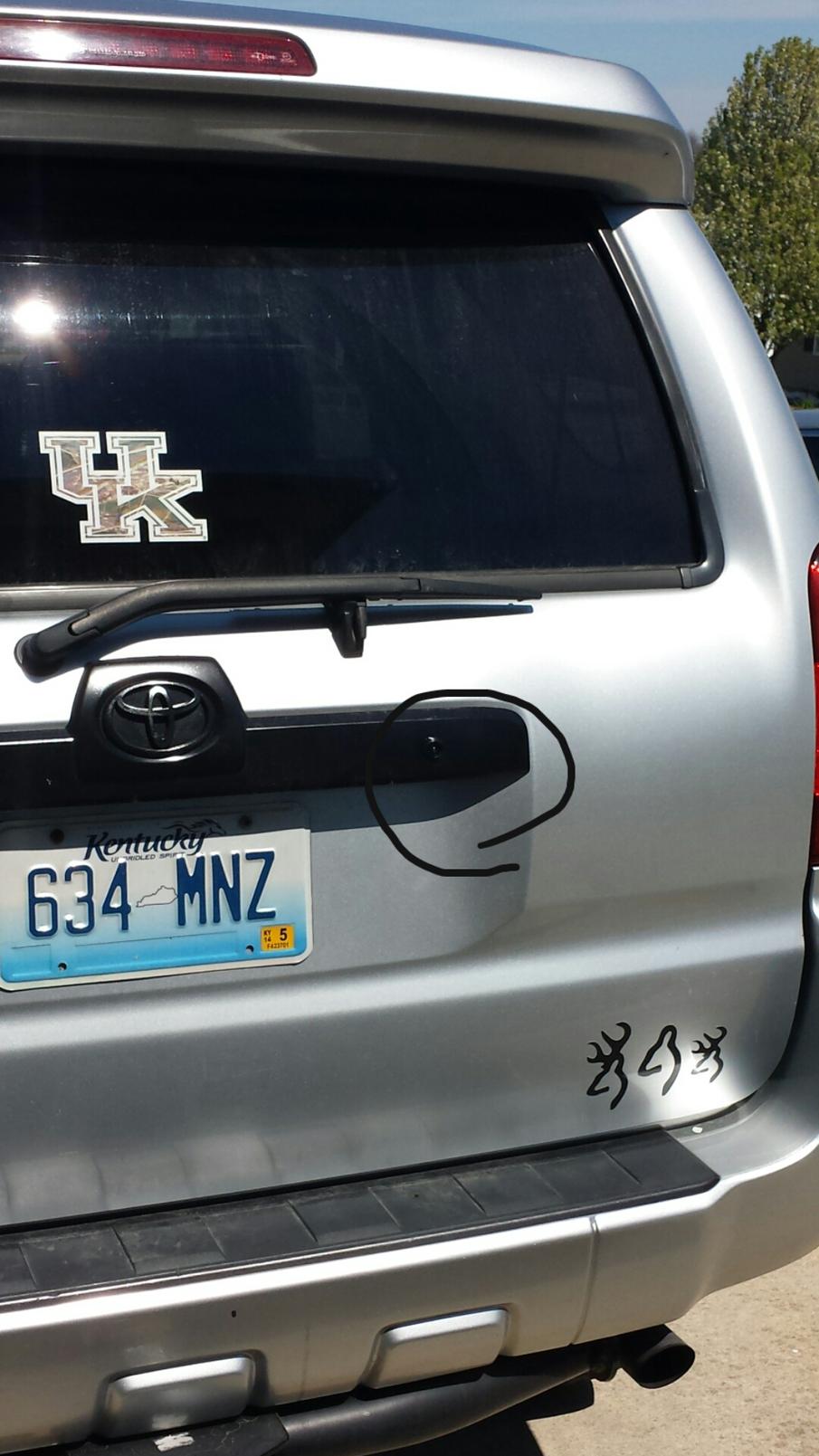

Installed camera and monitor a while back and just havent gotten around to sharing..eventually want to use the factory rearview mirror monitor if I can get my hands on one for a decent price but this will do for now

I like the view you have with that, which one did you use? I want to add one to my travel trailer.
The camera i bought off ebay some china man crap but for 3 bucks it works great..couldnt find another keyhole camera so opted for this one..liked the clean look rather than one hanging from the rear plastic panel
