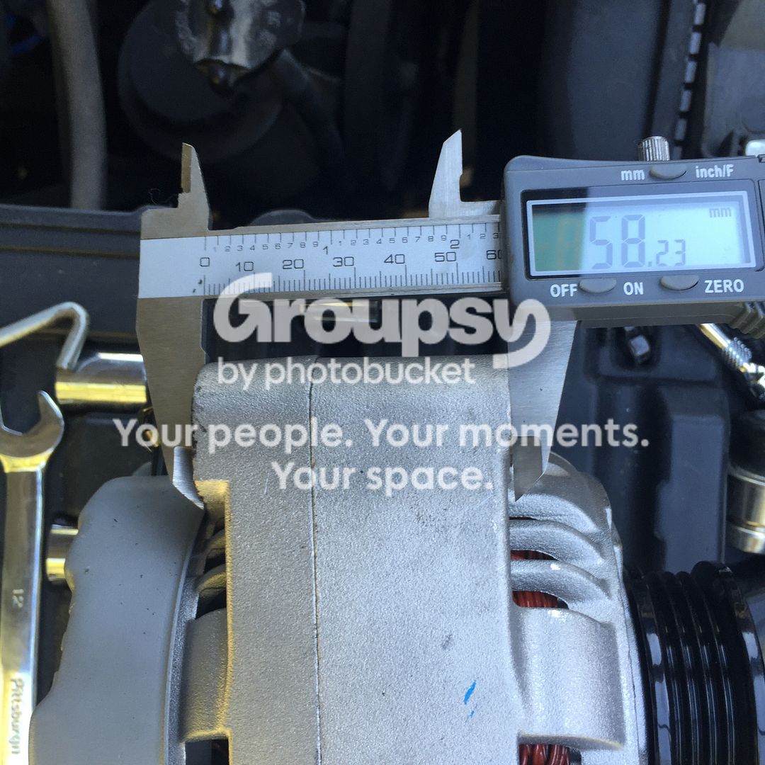

I seriously considered grinding it down, and I would have if I couldn't adjust that sleeve. But I decided to exchange it again first and try to get a better fitting one.
So off to the parts store I went because I decided that I wasn't going to screw with it all day. But first I grabbed my digital calipers and measured the new alt. It measured in at 58.23mm.

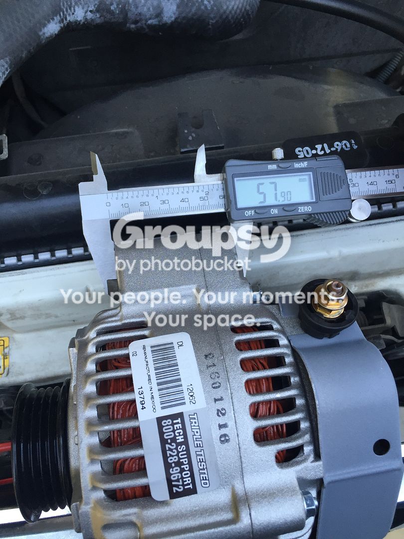

After discussing it with the parts store guy, I asked to see my old alternator. I measured it at 58.03mm.
I then requested a new alternator but of course they were out. I advised them that all 3.4L 3rd gens had the same size alternator but that 1999-02 came with a slightly beefier 80amp alternator. Luckily, they had one in stock and I measured it too. It measured 57.90mm
May not seem like much, but it was more than enough to prevent the first alternator from going back in.
So while a pain in the ass, I did get a slightly beefier 80amp piece of shit alternator — all under warranty.

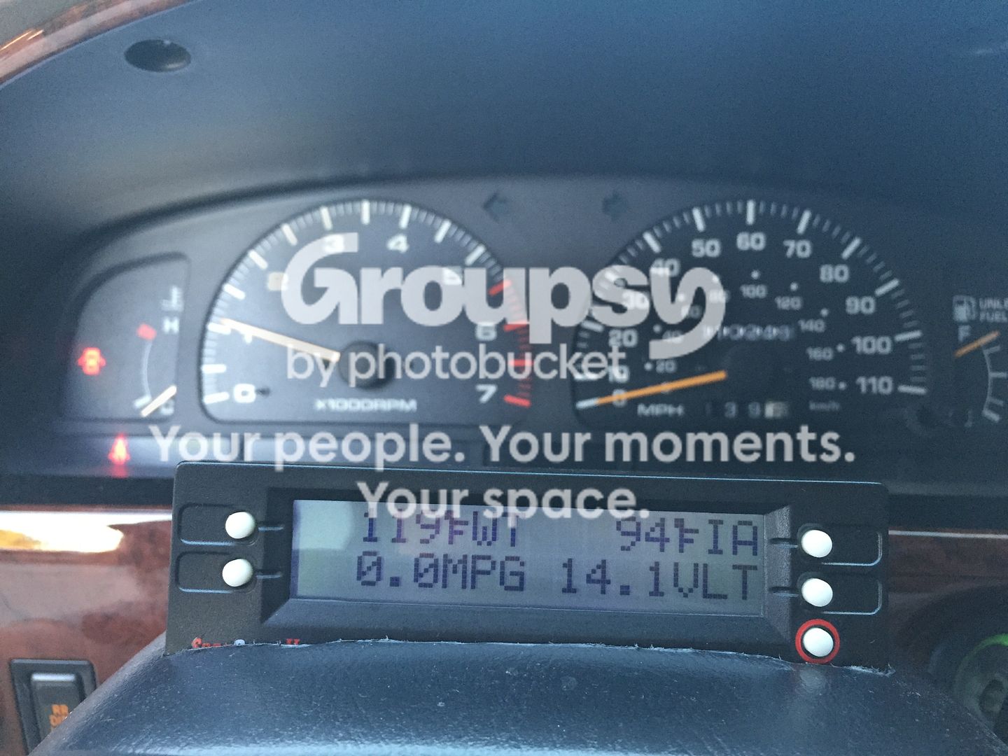

It started off at 14.1 volts but has bounced around between 13.4v — 14.1v even though conditions hadn't really changed. So I don't expect this one to last more than a year. Hopefully I'll have swapped it out before then.

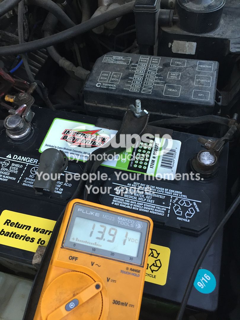

I did test the "new" 1999 alternator once I installed it though and it was putting out 13.9v which is kinda strange because the ScanGauge was reading 14.1v. Meh...whatever I guess.

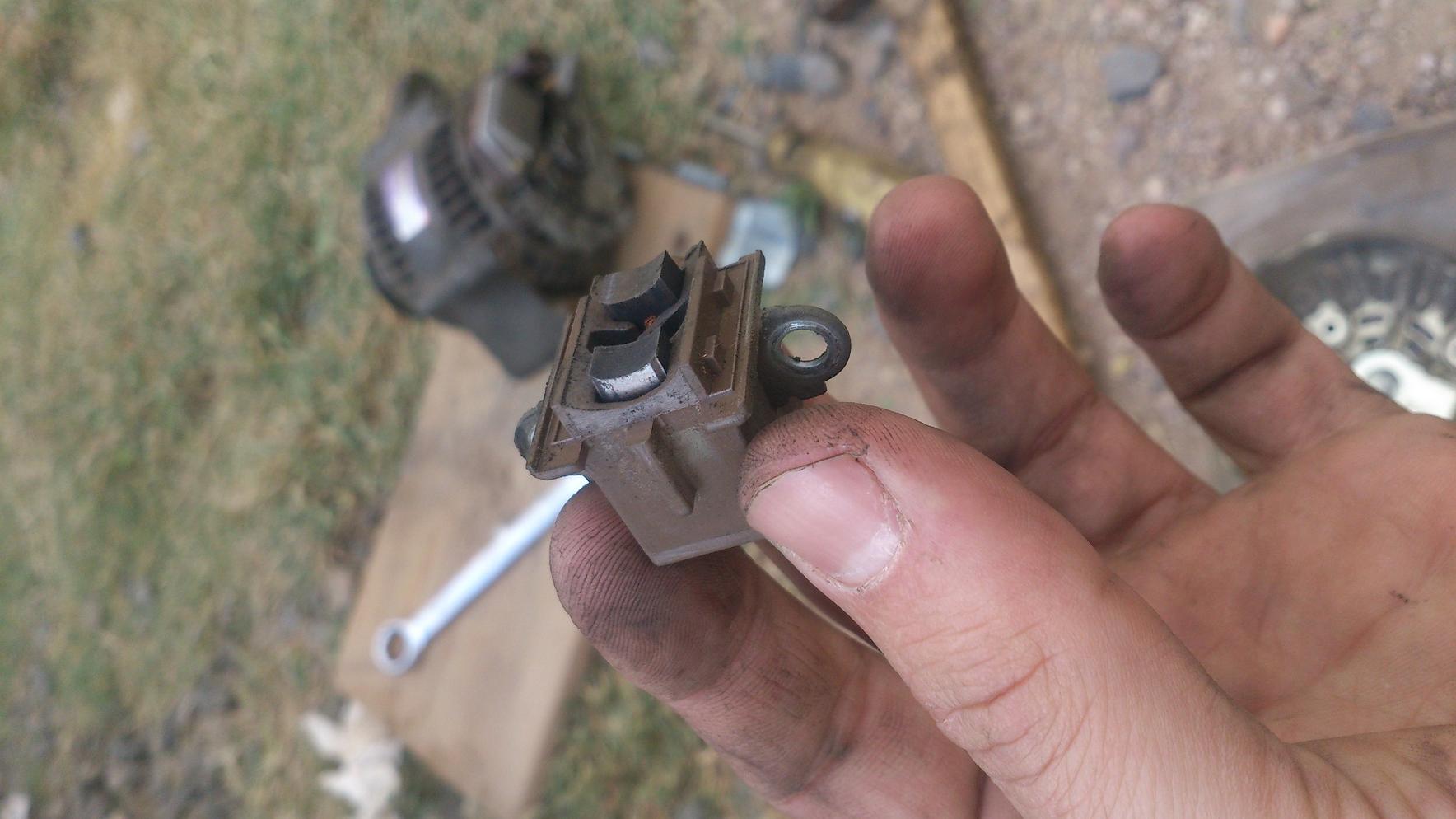

I think you alternator brushes went bad.
Alternators dosen't go out just like that,, i had an alternator with two working diodes out of three and still working fine, yes overloaded but working fine.
Even though you are thinking that your alternator died im 95% sure that the brushes went out, its easy to replace and costs nothing. I got OEM for $10 last week.
If you still have the old alternator it may be worth to replace brushes and keep it as spare or resell it.
In your case Alternator went our resulting in battery going low,, even when putting new battery you kept consuming without recharging.
As batteries dosen;t go out in one overnight, i suspect that your battery yes is old but may still have some life in it.
Next time, probably after many years, if faced similar situation please take a long steel thing and hit the alternator while engine is running, let a buddy watch battery light if it will go OFF when hitting the alternator. If so happened so then bad brushes.
The voltage test when engine is running while all lights and stuff are ON is for diode test. If 14.4 then all fine, if dropped between 13.8-14.2 still fine with idle but not fine when RPM is above 1500. If dropped below 13.8 you are having bad diodes.

Brother 13.9-14.1 is no good. Unless its just after start and battery is thirsty.
Take the ride for a reasonable spinn,, you probably did by now.
Voltage must be in your condition (new BAT + New ALT) is 14.3 with idle and high beam on with some other stuff.
should be 14.4 with 2000RPM with everything in ON.
if voltage keep 13.9 that means alternator is not good. (sorry)
check grounding wire from engine bay to Negaitve battery terminal.

I agree. All these others saying 13.8 is okay but imo it's not. 14.3v is what my 20 year old alt holds.
You will also need to get a proper positive battery terminal. Get the OEM battery terminal. It is well built and not too expensive.
just for future reference.
that little bushing in the mount is meant to adjust and be slid back. they are on MANY different rigs. its not really a sign of quality, or lack of, if a particular alt doesn't fit in that space. that's WHY that bushing exists...
also, 13.8-14.2 is pretty much a standard for good alternator output.
With no load the battery should be 12.7 volts.
I would check it with one of the cables disconnected for a bit.
That also gives you a reference point for your multi meter.
The FSM shows the charging voltage with no load at 2000 rpm's as
14-15 volts @ 77 degrees F
13.5-14.3 volts @ 239 degrees F.
I can only assume that's the temp of the alternator.
