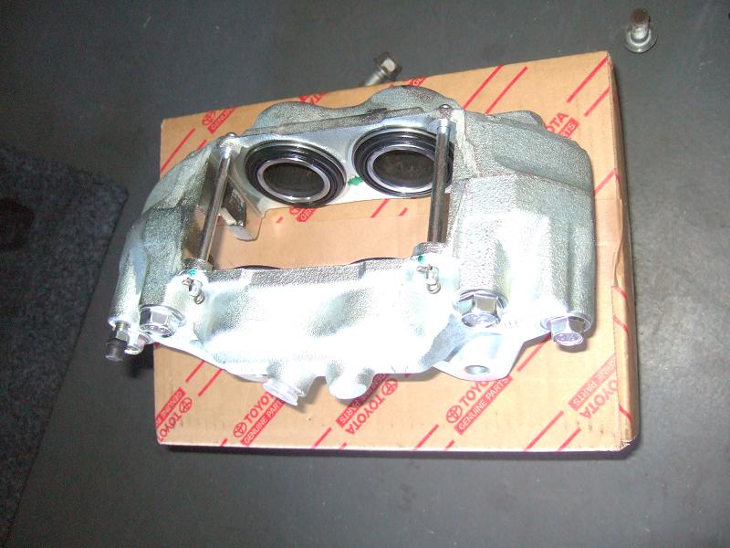

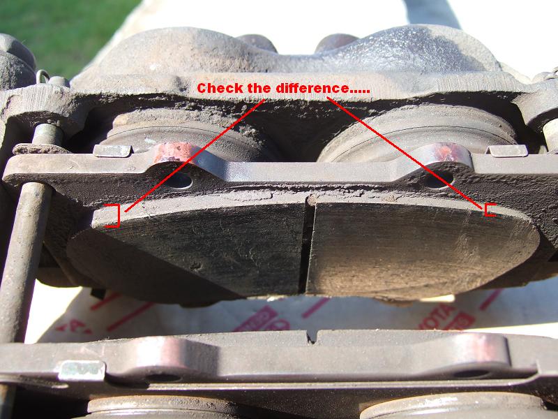

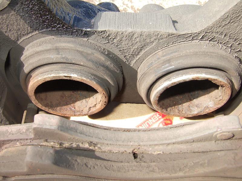

OK, after ordering the new Right Side caliper and changing it this weekend, I took some pics to show how jacked up these calipers can be, since it seems we're not the only ones with this issue....at least so far no one's gotten into an accident because of this......
Background: Currenty I have 63K miles on my 03 Sport V8 and this was (2 months ago) my 1st Brake job for the T4R....Right side, Front was BAD,..... RUSTED solid piston cups on the outside positiioned pad which actually froze solid one of them...ths caused one side of the pad to wear more (or less than normal) than the other.
Fortunately, the brakes still held when applied but I put the order out for a replcement pronto,
Maybe someone will catch theirs early and be able to claim it under warranty....

Nice pics. That shows the problem well. The rust on the inside of those piston holes is normal. But I do see what you mean by the thickness of the pads being different across the length. That is obviously a stuck piston. Glad the part you ordered was correct.
