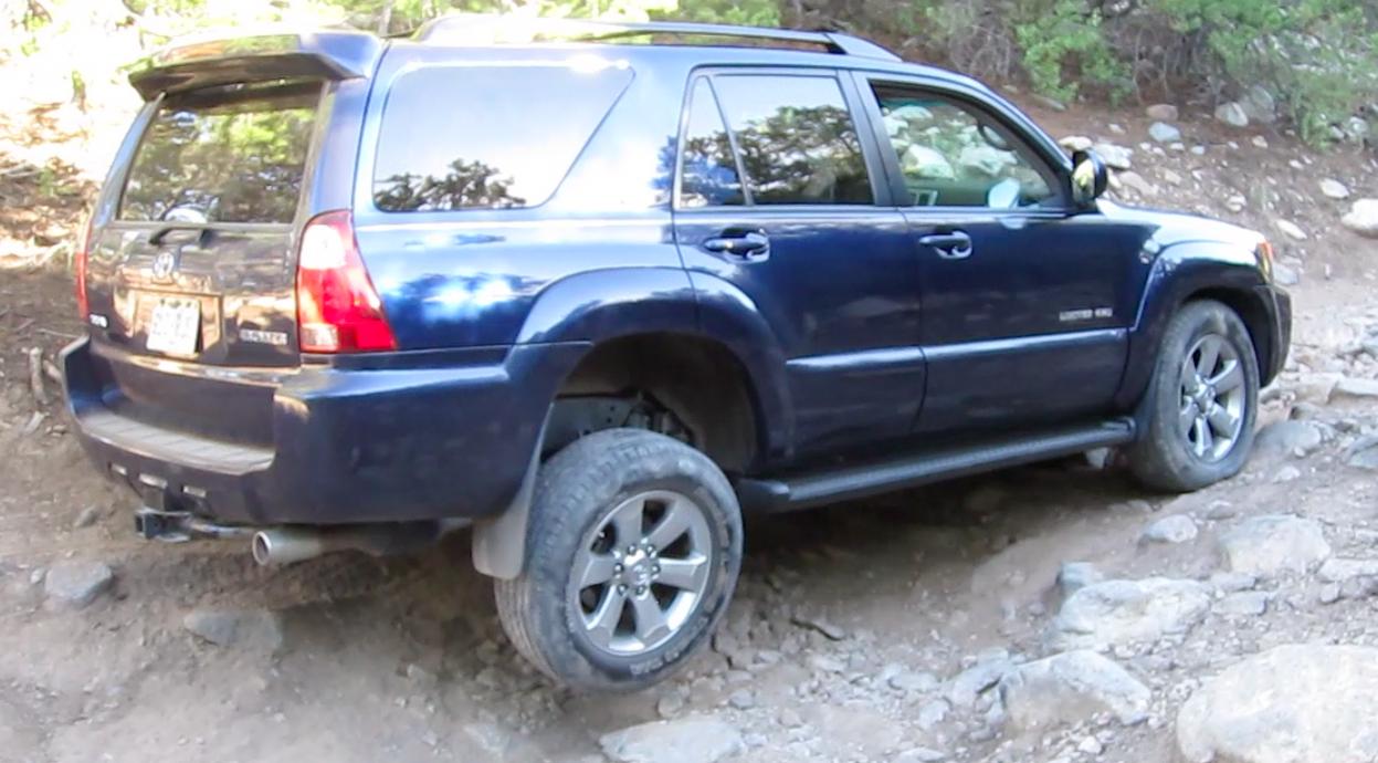

Yes the ATRAC was helping. But, does the new 2010 Trail have a locking rear axle? And here is a photo of the exact time I was talking about on Lake Como Road. I'll have to upload the videos from that day later. But now my skid plates are practically trashed.

Nice pic:D
