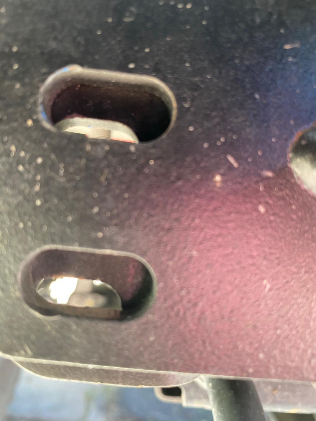

The heat of the problem is that the mounting instructions show that the frame has changed on the ‘20 4Runner as compared to the online instructions. In the instructions they have you install a washer and nut on a stud welded to the frame. On my ‘20 ORP, it uses 4 flange bolts. Additionally the instructions have you drill out the frame where the power steering bolts mount in order to mount the support plates that actually take up the strain of the pulling force.
The issue is that because of the flange bolts these side support plates do not align with the Stronghold bumper and are about 5mm off, about half of the bolt whole is now blocked.
I bought the bumper Memorial Day, mounted it a couple of weeks later and originally contacted Metal Tech on the 25th of June, being put in contact with John Love. Since then the only response I got from them which even attempted to address the issue was last Thursday when John told me to just loosen the bolts and try again.
I have provided numerous photos to him showing the issue. I have explained that while I am not an auto mechanic I have over 20 years experience working on boiler steam systems and gas turbines. I have a fair idea of who mechanical systems assemble and I’ve tried explaining that it is the change in bumper mounting from the factory that is causing this issue.
In my opinion, the way to make this right, is to change the design of the side mounting plates to make up for the 5mm misalignment. I’m not trying to drag their company through the dirt, only trying to help them fix a flawed product, but the fact of the matter is that I have had roughly a dozen contact attempts without them even acknowledging a problem with their product or attempting a resolution.
My hope here is that I prevent anyone from experiencing the same issues. I’ll also attempt to upload photos of my issue for you to see. Finally, the bumper was $925 shipped, required drilling of the frame and cutting of the bumper cover. There is no way I can go back with this mod which further complicates the problem I have with Metal Tech.

This could be a slight manufacturing difference between years or maybe their jig was off a hair that day. Sure they should have replied to you. But honestly with Covid going on customer support from every vendor I have dealt with since has been lackluster. I work in auto restoration and I call vendors all the time. And on that note I learned a LONG time ago NEVER expect anything that's listed as a bolt-on to truly be a bolt-on. Nothing fits like OE especially when you get to stuff like this. This is minor compared to some of the stuff I deal with that's advertised as bolt-on. A couple minutes with a die grinder and this would be good. Sure you shouldn't need to do that but trust me it's nothing new.

Yes, I own a drill, that’s not the point of this review or my continued attempts to contact the company. Metal Tech used to be a company that I liked doing business with.
There has been an obvious change to the mounting of the bumper subassembly from the factory that they need to take action on. The fact that they are marketing a $925 bumper that doesn’t fit out of the box and aren’t interested in addressing or updating should be a warning to any future customers.

Did the OP even bother to try to do what the manufacture says.
If one side bolts up or the holes align on one side, and the other side doesnt, then just loosen ALL the bolts and try to get all the bolts to seat before you tighten anything will actually help with the alignment even when it looks all but impossible.
I had this issue with another manufacture's bumper also, and it had installed just fine when I test fitted it, but when I took it off to install a winch, the bumper wouldn't fit. It took me a while to figure out what i did wrong. It was due to the tight tolerances. I had to loosen everything to the point that the bumper was barely hanging on by one bolt, and it was then, i can start ALL the bolts. Once, i got the bolts in barely, I had to tighten the nuts a little by little alternating from one side to the other. Otherwise, no bueno.
Toyota frames also have weird tolerances too....so I wouldn't point fingers at the bumper manufacture as the sole source of your problems.
