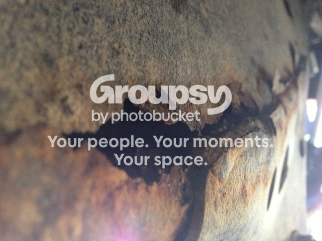

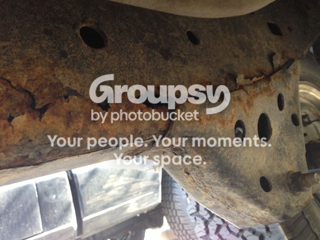

I was installing my lift the other day and found some wicked frame rust and rot. My question is how much is too much? I have a guy who is gonna look at it and give me a quote on repair. He says we can maybe weld a plate on and sand and paint the whole frame with some POR15.

Thats where they are all starting to go bad. I would cut the metal out and paint the inside and outside of the frame around that area. Then reweld a nice piece of metal in its place. I had mine done this way and its holding up fine.
I used Eastwood rust and chassis paint. It was like a 3 step process. I haven't been very impressed with it so know I am going to paint my whole back end in Masterseries paint. Eastwood does have an internal frame coating which I sprayed in my frame rails. I would just take whatever rust coating your using and paint the inside of the rail that is exposed when you cut out the bad section. It is rusting from the inside-out.
I don't know man, don't mean to piss in your Cheerios but that looks pretty bad. Is that at the control arm mount? It looks like the control arm mount is pulling out of the frame. Can you take some wider pictures to help out it in perspective?
Yeah I know its bad and I want honest input so please don't worry about pissing me off. I'll take more photos and post up tomorrow
can definitely be repaired , i had the same problem [not as bad as that ] but rotted in the same place . previous owner hid it from me with epoxy and fresh under coat .
just cut out all the rot and box it out with 1/8 '' plate . rear control arm mount is thicker than the frame . i welded the plate to the control arm mount and extended the plate to were the frame is good . did it on the inside , outside and bottom of the frame on both sides of the frame .
i have torches and welders in my shop so it didnt cost me anything , but even if you had to pay a welding shop i can't see it being too bad , if i had to guess i would say 700 to 1000 bucks , have to pull the gas tank and exhaust system .
I've seen guys pull rare muscle cars out of woods with sections of the frame rotted away and missing and they repaired them , anything can be fixed .
Awesome thanks woodro that helps. I was sick to my stomach all day worrying about it. I'm nervous about what I'll find on the other frame rail when I drop the gas tank.

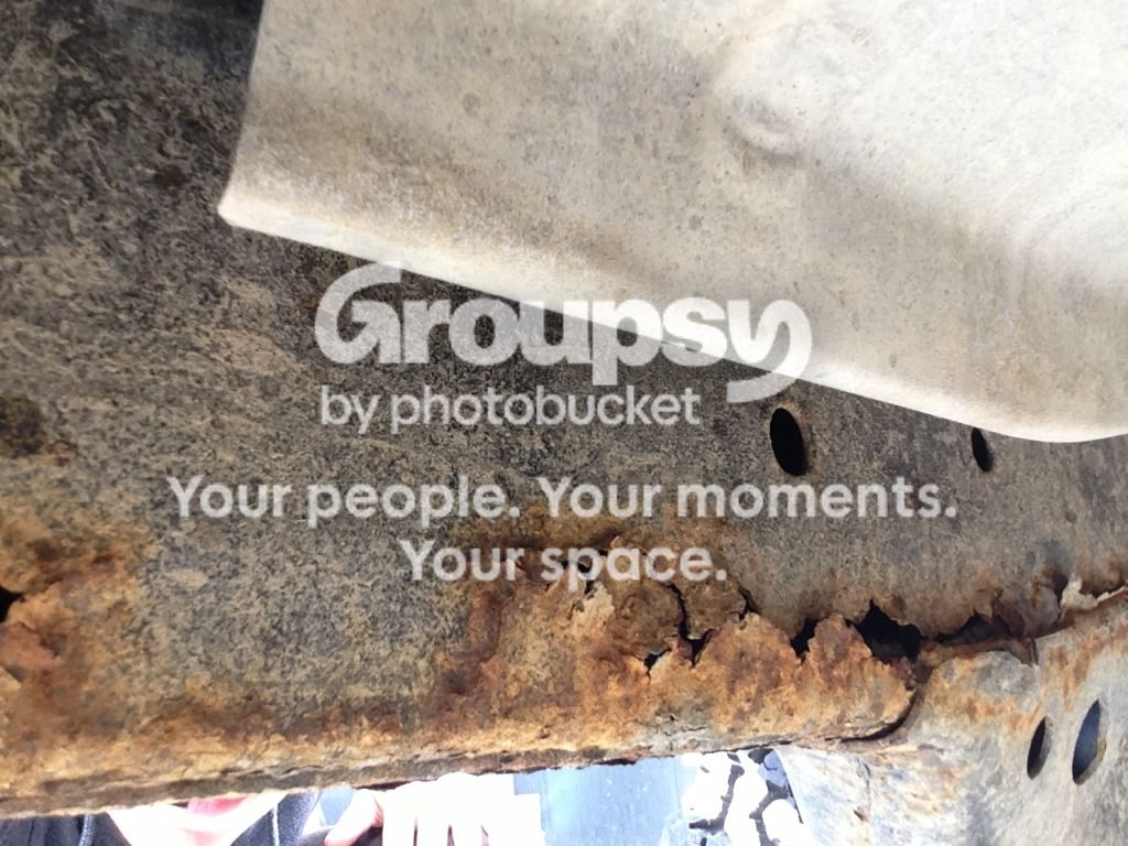

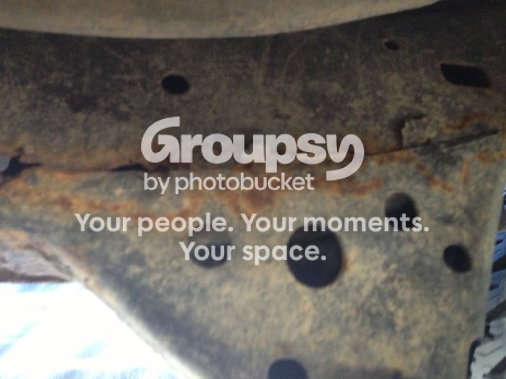

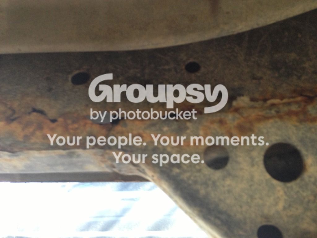

Thanks man you're a big help. I will order that ASAP. Meeting with someone to patch the frame this Sunday. Here are more shots like you guys asked.

Does this help?
control mount looks ok , just make sure you cut all the rusty material out .i used a grinder with a cutting wheel . definitely easy fix .
i used 1/8 '' plate , little bit thinker then the frame . ill post up pic if i can figure out how to ,if not pm me your email address and ill send you the pics of my repair .
