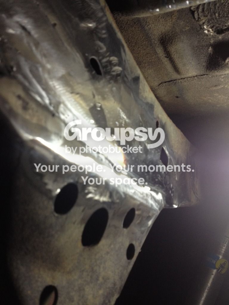

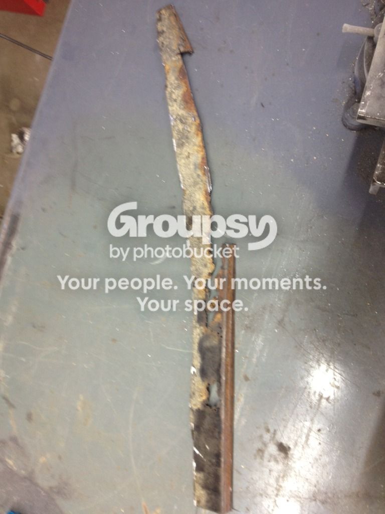

He cut out the old rusty area:
041_zps0131581e.jpg~original
040_zps88f40366.jpg~original

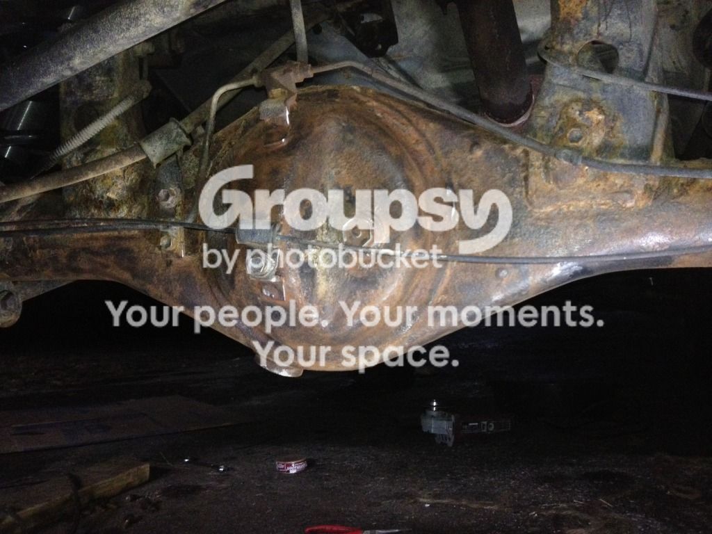

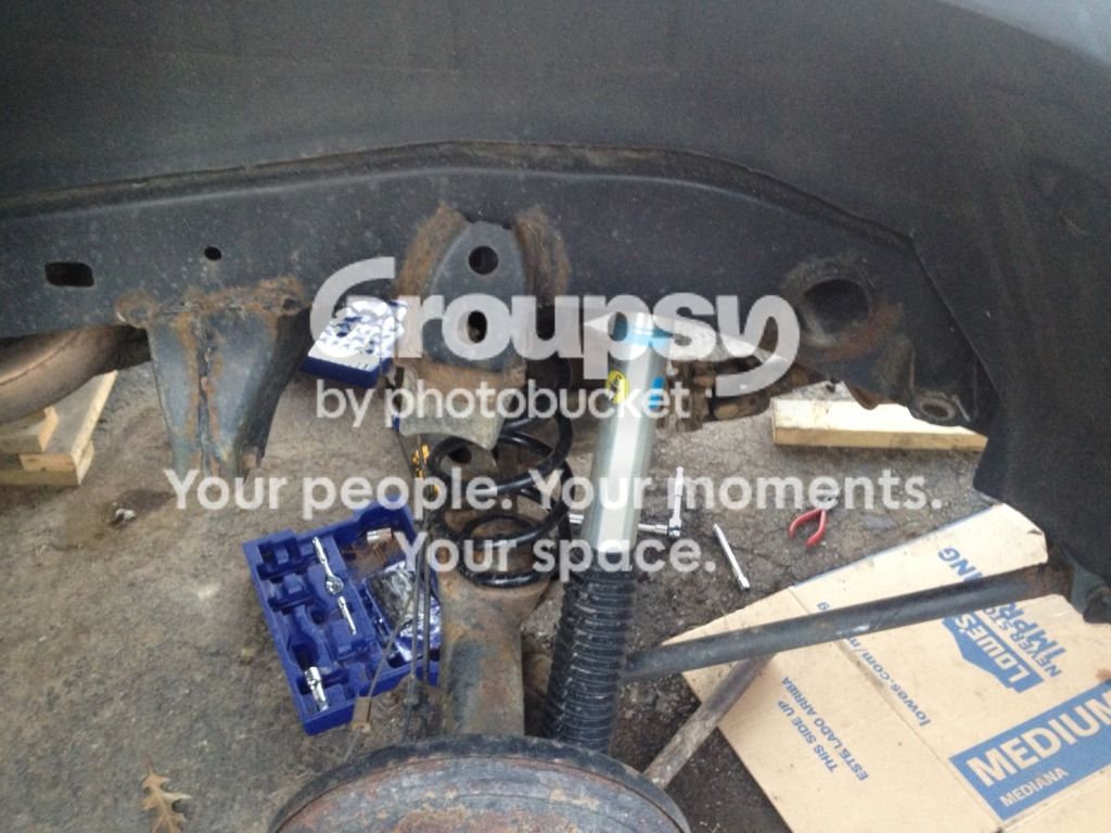

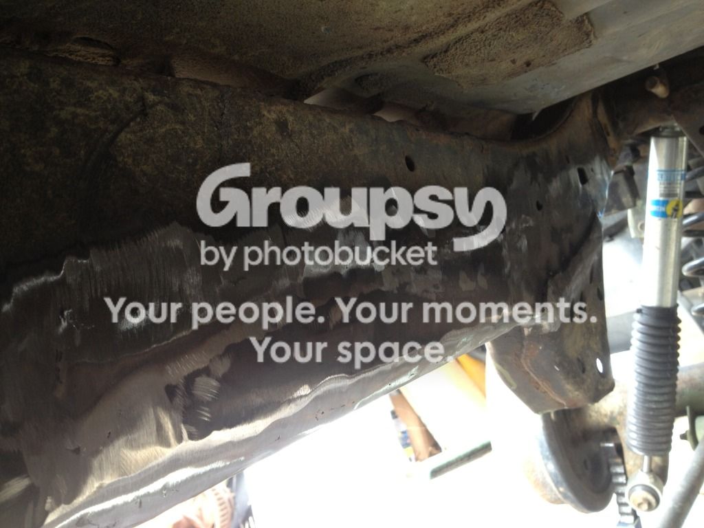

Then sanded the rust off of everything:
036_zps3c75f40d.jpg~original
030_zps1bc9a34e.jpg~original

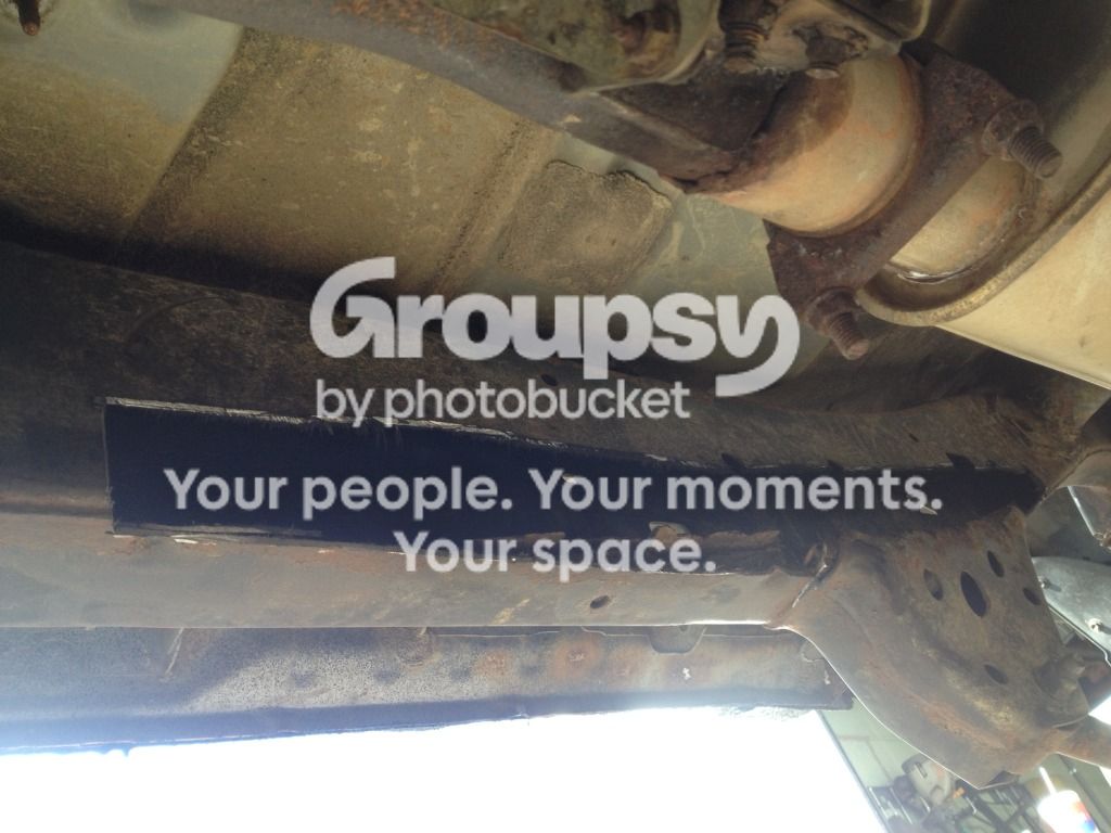

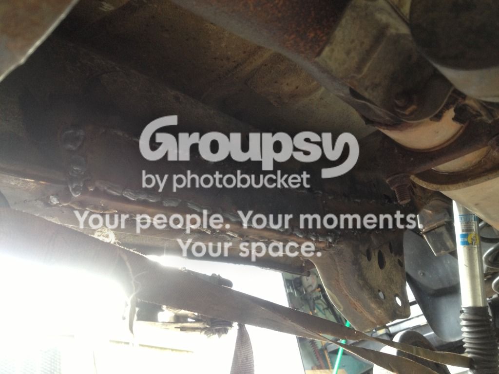

Welded the new metal in:
043_zps13cf5ff4.jpg~original
Then cleaned it all up:
049_zps619d4ddd.jpg~original
044_zps284d47bb.jpg~original

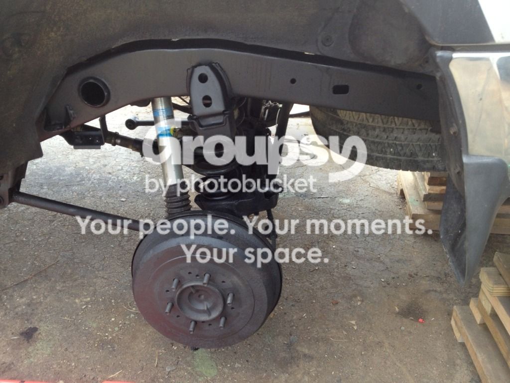

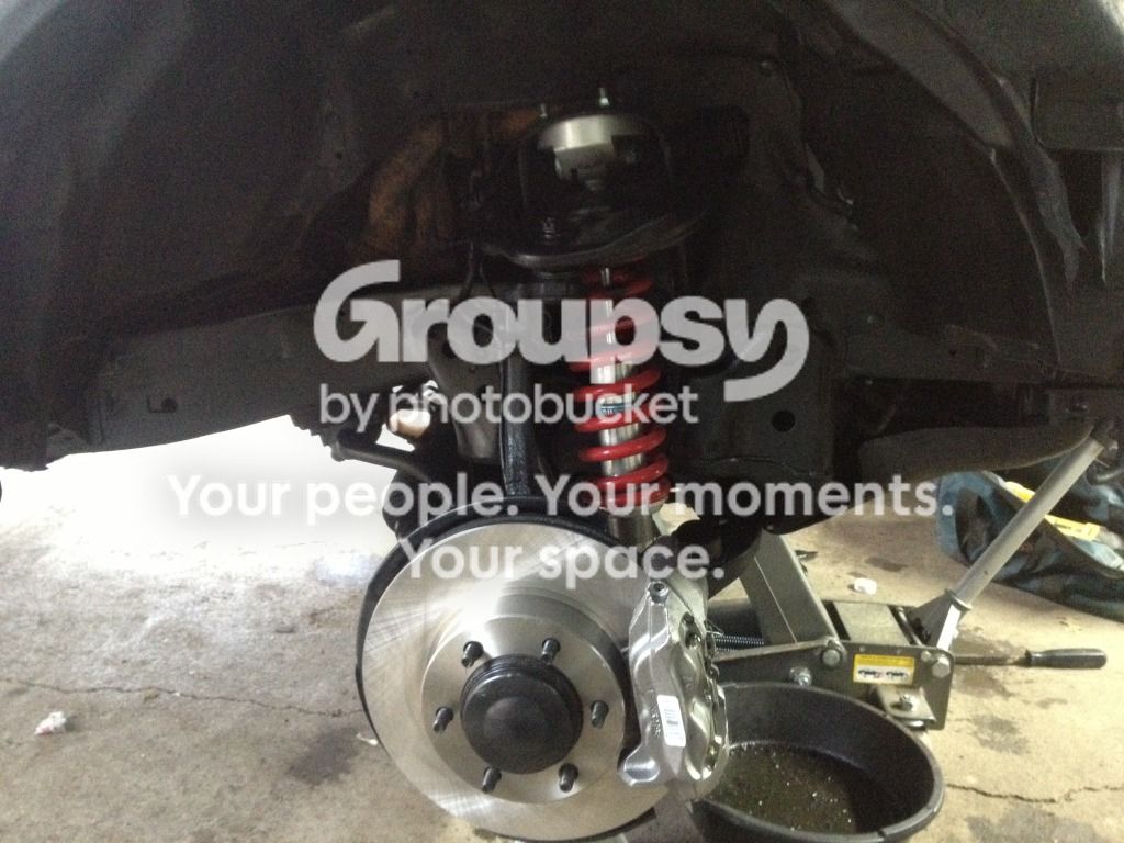

Lots of prep work. Then coated inside of frame (no photos) and painted everything with rust encapsulator and then painted over that with eastwood frame paint.
087_zpse311cd8c.jpg~original
067_zps15223e7f.jpg~original
065_zps91f50a45.jpg~original
Good job , looks good . People see frame rot and think its the end of the truck . Little bit of know how and some elbow grease go long way ! That rear diff looks brand new .
