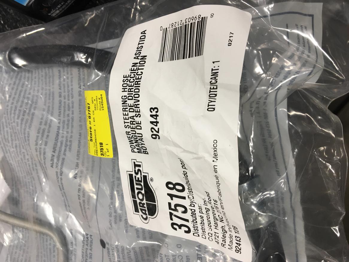

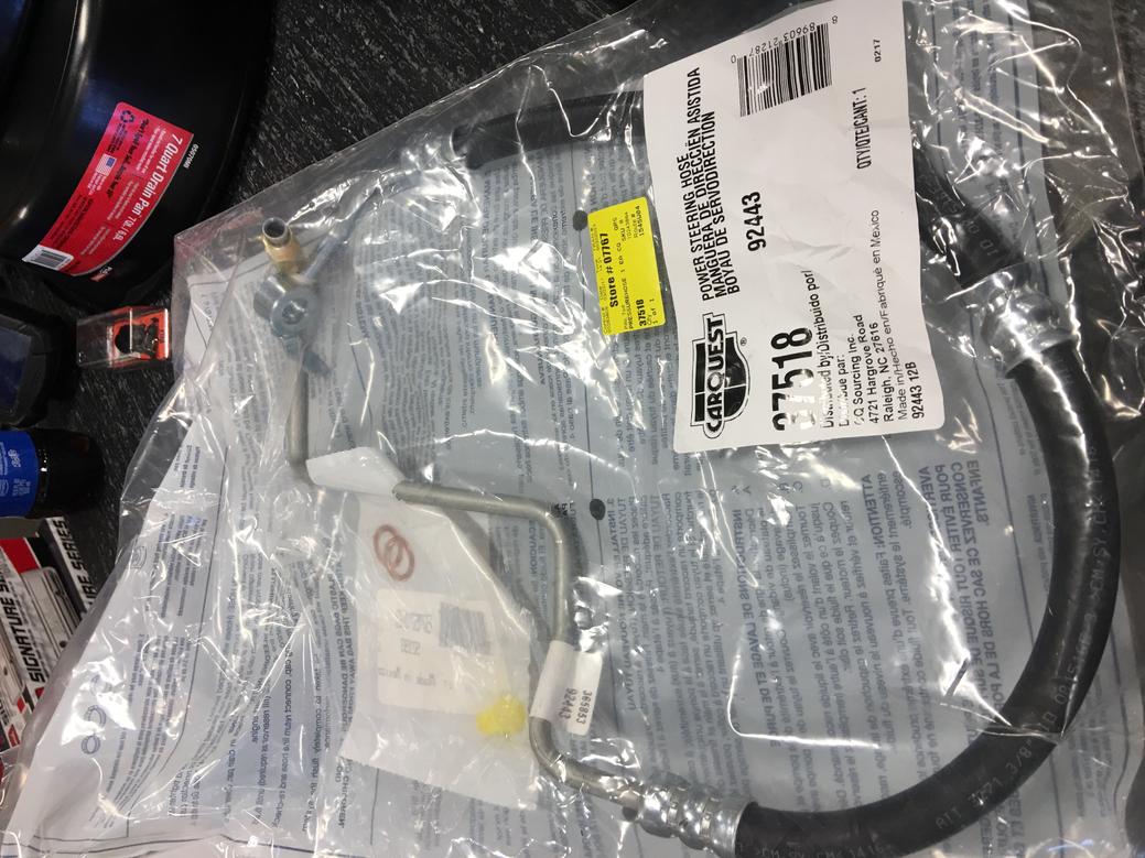

Mechanic said it's leaking from the metal hose. The below pic is what I got? do I need anything else. This part came up based of the part # from toy

Well you should compare it to your original hose to make sure it's correct and the fittings are the correct size. You will need fluid and the procedure to bleed the air from the system after install. Usually this entails filling the reservoir and turning the wheel lock to lock a few times while checking and adding fluid. Don't let it run dry and also check for leaks. Check procedure for your vehicle.
