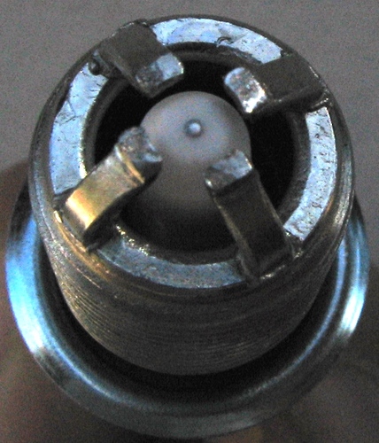

Make sure you use dual electrode plugs. The ones you referenced are single electrodes...

Just for the record, I installed NGK iridiums and the truck runs strong and improved my gas mileage from 14 to 16 mpg. Now I'm working on new fuel injectors today and it wouldn't surprize me if I didn't get an extra 1mpg from replacing the bad #2 injector. The dual prong plugs are needed because the ground electrode gets chewed up in our "wasted spark ignition" systems. Having two grounds makes them last longer. You would do just fine with a double platinum plug as well since it won't erode like the factory plug will and open the gap in a short 30k miles. The key to getting the right plug is make sure the center electrode is exposed like the old fashion plugs were. Bosch are crap but beyond that, Bosch imbeds the electrode in ceramic so it doesn't spark in reverse very well.
