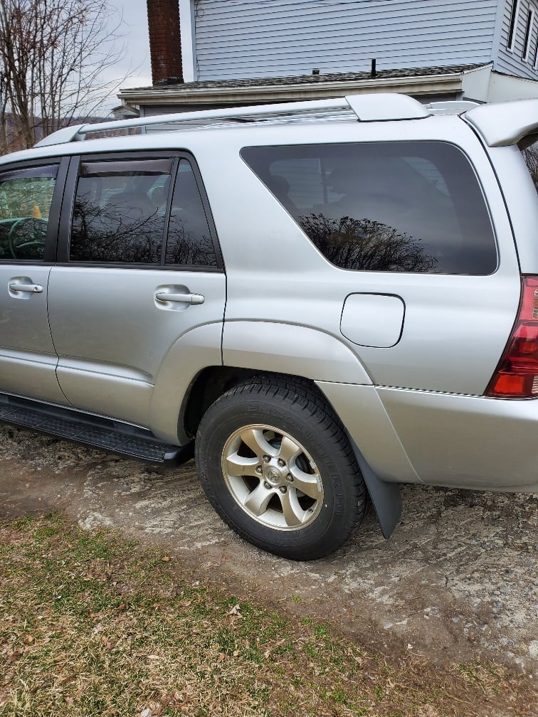

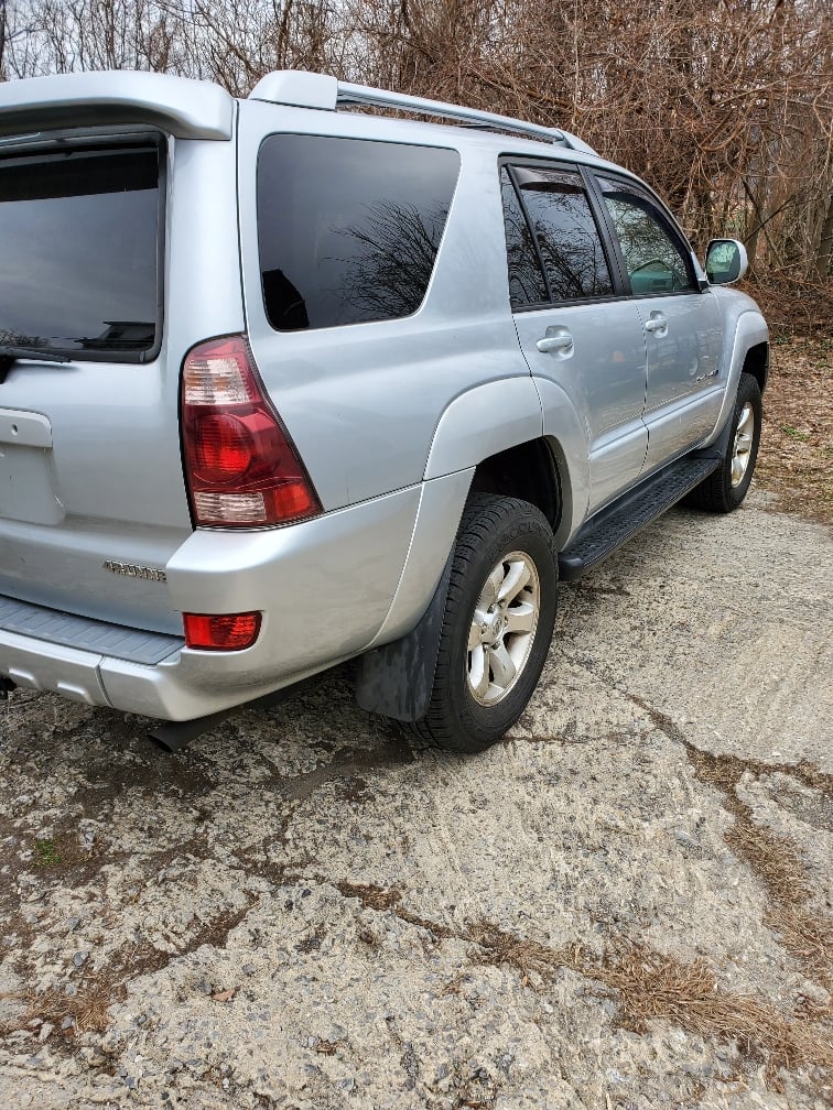

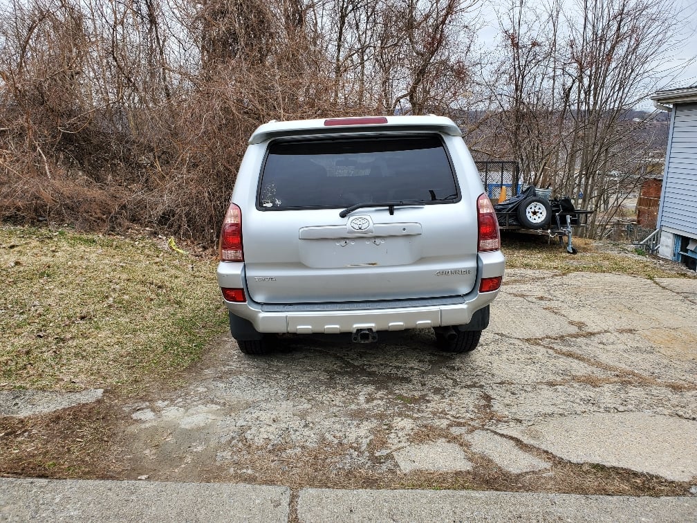

I haven't gone and checked yet since I dont have time but I kust noticed this today. Just more stuff to frustrate me. And I also checked it on level ground aswell.
Thinking now maybe the spring is just weak

Have you looked under there, with that much sag the spring could be broken, or something else let loose, maybe a shock mount, I would be looking at that soon just so I knew what wasn't causing it if nothing else!
I should have mentioned i did look at it real quick and didnt see anything jumping out at me. New shocks and eveything connected there.
Didnt notice any spring issues when i was installing. Everything I took off was very worn.
I'm thinking might just do new springs but I kinda wanna lift the back up a bit and level it off now after seeing the difference.

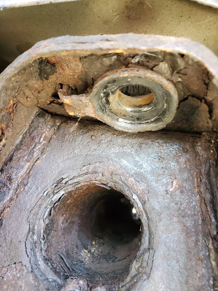

So just took apart and found this. The other side doesnt have it and I dont remember seeing one falling to the ground.
Lots of rust flaking but its solid under it
Sent from my SM-N975U1 using Tapatalk
What is that?
Im guessing it was part of the original shock that just didn't come out when I removed it and missed it. Was stuck in there pretty good. Maybe the other side had one and I just dont remember.
Popped it out and reinstalled new shock. Def looks better but I still think there is about an inch difference.
Maybe now its just the normal lean I've been told about? Maybe now Ill look into lifting the back up a bit to match the front as cheap as I can.
That spring either popped out of its seat or it broke, or both.

I did some measurements the other day finally and while only rough and didn't check the tire pressures this is what I got.
Driver side front and rear 34 1/2
Pass rear 36 1/4
Pass front 35 1/2
Everything looks good with the springs and how they are seated and such.
Would a spacer on the driver side help this maybe? I've seen some videos of them being put on the driver side to help with the lean.
