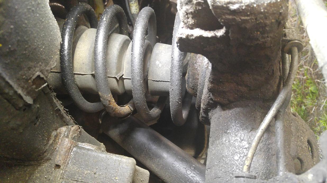

picture of my rear spring, of course spring got in the way, not exactly sure if its 2 inches. I'll go in with tape measure when its light outside.

Can't give much insight to the broken shock but I've owned 5 toyotas, 3 tacoma and 2 4runners some lifted and some not but honestly all of them felt pretty rough on the back end going over speed bumps. I think its kind of just the nature of the beast.
Wow.. You got a pic of the whole trucks side to see how she's sitting?
That's low in the back if you ask me.
The ride is ajaring, and i don't want to blindly spend money. My guess its a combo of this and tires.
Oh rear shocks are not broken, they were broken, but fixed with OEM shocks, just I thought it would ride like new shocks, but still ride like crap. Front rides very well though.

let me see if i have one. it doesn't seem to be sitting low . ive seen picture of sagging 4runners, nothing like that. but it is pretty darn close.
That's what my sagging '98 w/344k mile OEM springs looks like. I bet you won't even be able to fit your fingers between the bump stop and the lower perch. From the looks of it I'd say it's less than 1". You have to measure from the bottom of the bump stop to where the bump stop would hit the metal stopper vs. bump stop to bottom coil.

wow because of this I am going to change them. And pretty confident this will fix the issue... thank you for sharing! I was hoping to get away with moog springs, but i hear that just doesn't work as well as oem. I'm debating if i should put 02 springs or 99 springs now. Not sure if it needs to be balanced with the front suspension or if that all makes a difference. Endlinks and bushings are shot so Ill do all of those in one go. but looks like that will be about 250-300 dollars + Labor. sounds like your springs were worse than mine, i only have problems when i drive under uneven roads. the only vibration i feel on freshly paved road is the imbalanced tires, but that is another issue.

Wow ! look at all that extra space!!!!! you have at least 2x the space than I do.
Holy cow! Rear springs and rear shocks should go hand in hand no matter what...
