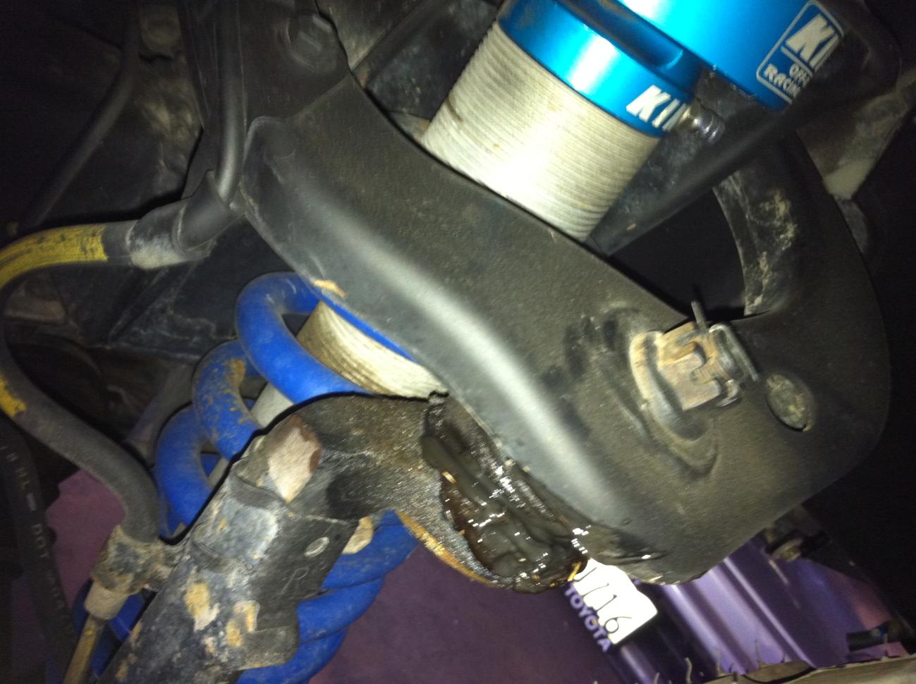

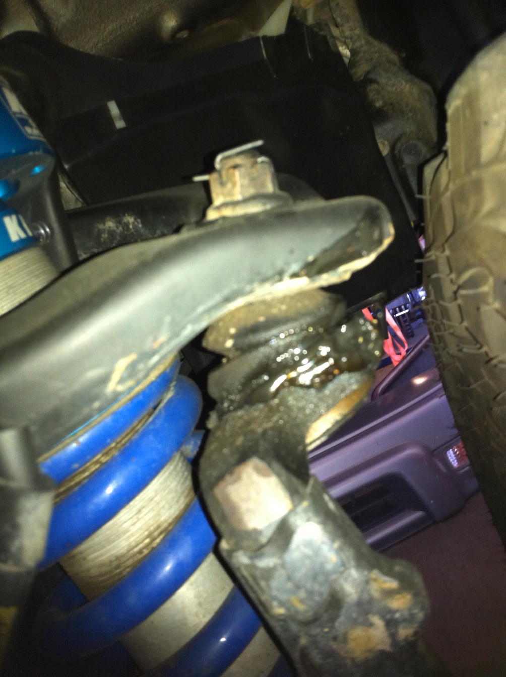

tmaxx13
I have grease leaking out of both of my Upper Ball joints, Just curious to see if it is ok if they are on this angle and if i just keep re-greasing the joint so it doesn't run dry, or if this angle is to bad what can be done to fix it besides reducing the rake, would new UCA like Camburg or All-Pro help to fix this problem, if not what would, Thanks

The upper BJs don't see the same kind of stress that the lower BJs do so it's not as big of a deal, but yours are still being overstressed. You could adjust your coilovers down a little bit and that will help, but if you want to keep your lift height, aftermarket UCAs would be the best choice IMO. Some UCAs have a uniball design instead of a ball joint (like the Total Chaos ones). Others like Light Racing have a ball joint still, but it's heavier duty than the stock BJs. I have heard that the uniballs corrode easy if you live in an area where they salt the roads so that may or may not be an issue for you.
I live in CA and they don't salt here so I would go with a uniball design personally, but something to think about.
EDIT: You live in SoCal too, so I would go with whatever design you like the best for the price.

x2 on total chaos all my friends run them, just make sure to keep greasing them so they dont squeak
Brian thanks for that info, i have never seen those Light Racing ones, and as i just moved to anchorage Ak and i hear they do salt quite a bit that might work out better for me, and the price isn't that bad at all, I think i will have them changed out and hopefully that will help the angle some, you said normally the lower ball joint get more stress, any way to fix that as well?
there is no real good way to fix it, because the weight of the truck gotta go somewhere, especially with us guys running heavy bumpers, but if you run made in japan LBJ you should be fine.
yours isnt too bad the boot from where i can see looks good still so just repack with some grease and stuff the boot back in place
