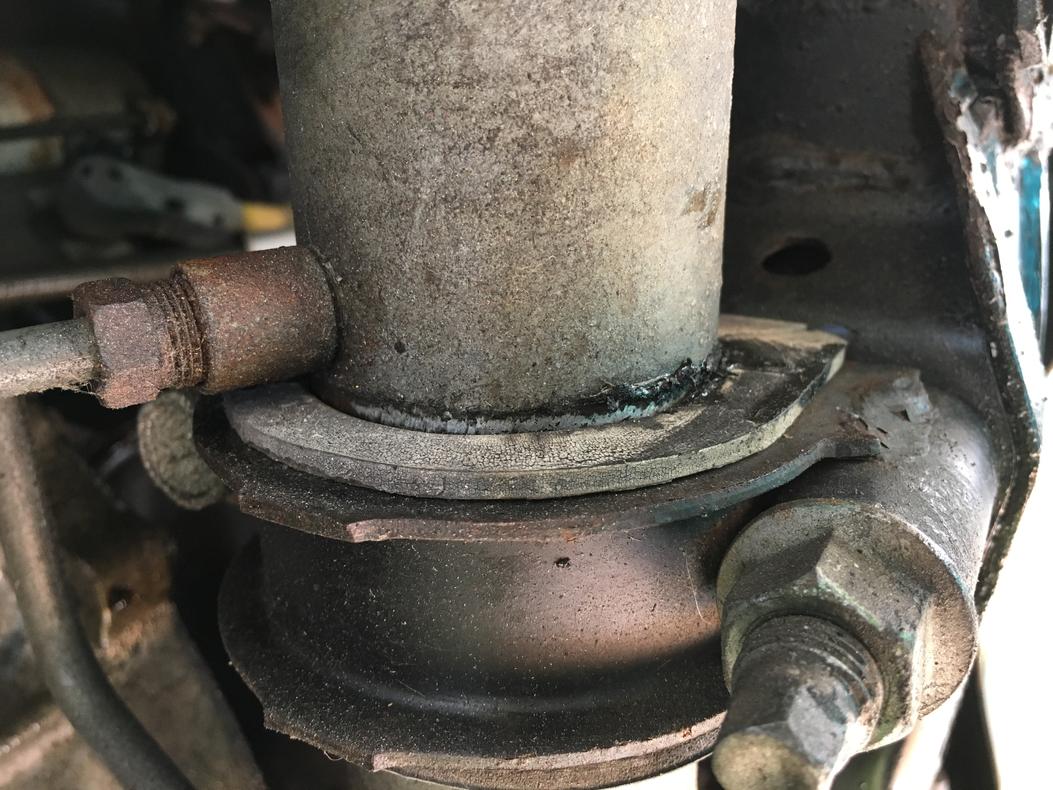

I noticed that the steering rack is leaking more than it was, and there's shiny metal next to the passenger side steering rack bushing, which tells me the bushings need to be replaced.
Could this cause a vibration like that? Sorry for the huge pic, I'm posting from my phone and can't resize.
