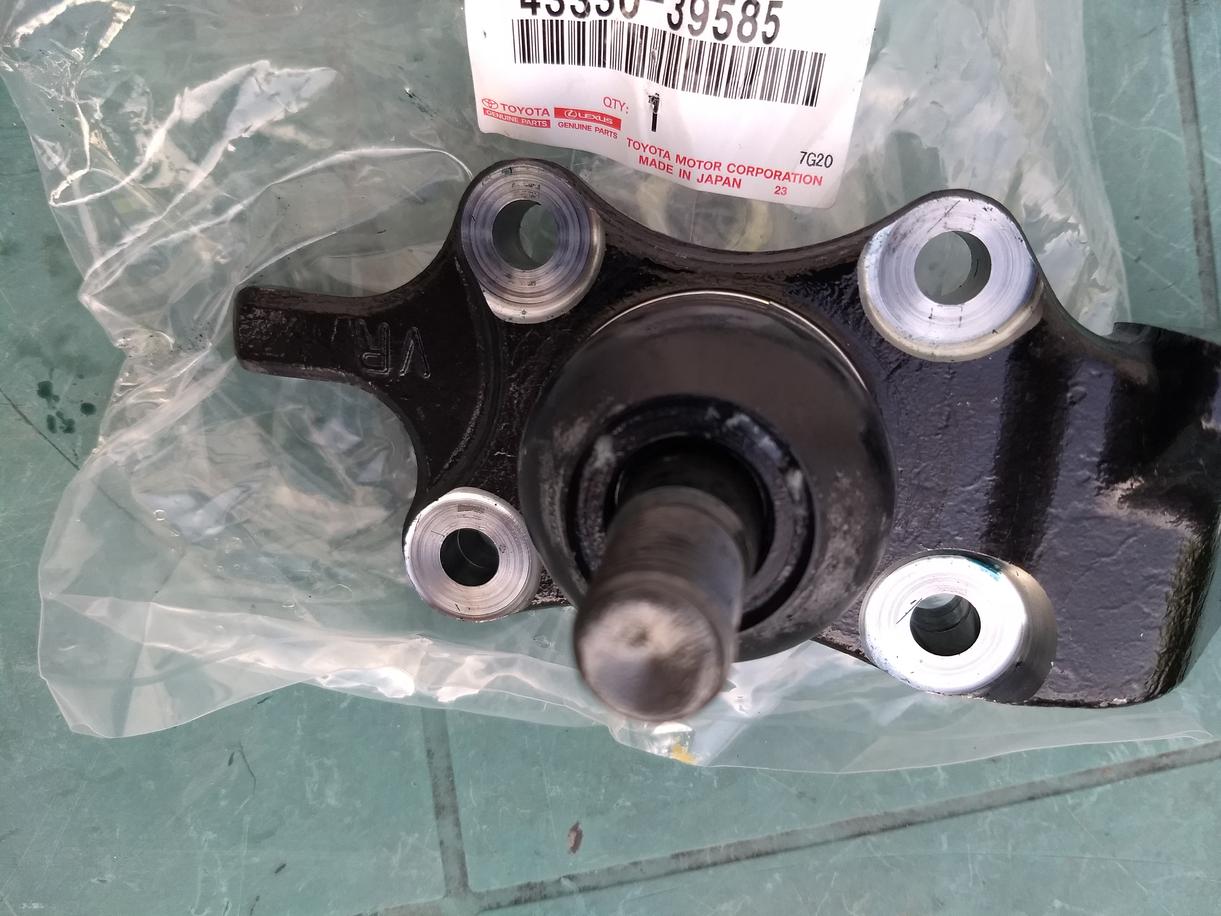

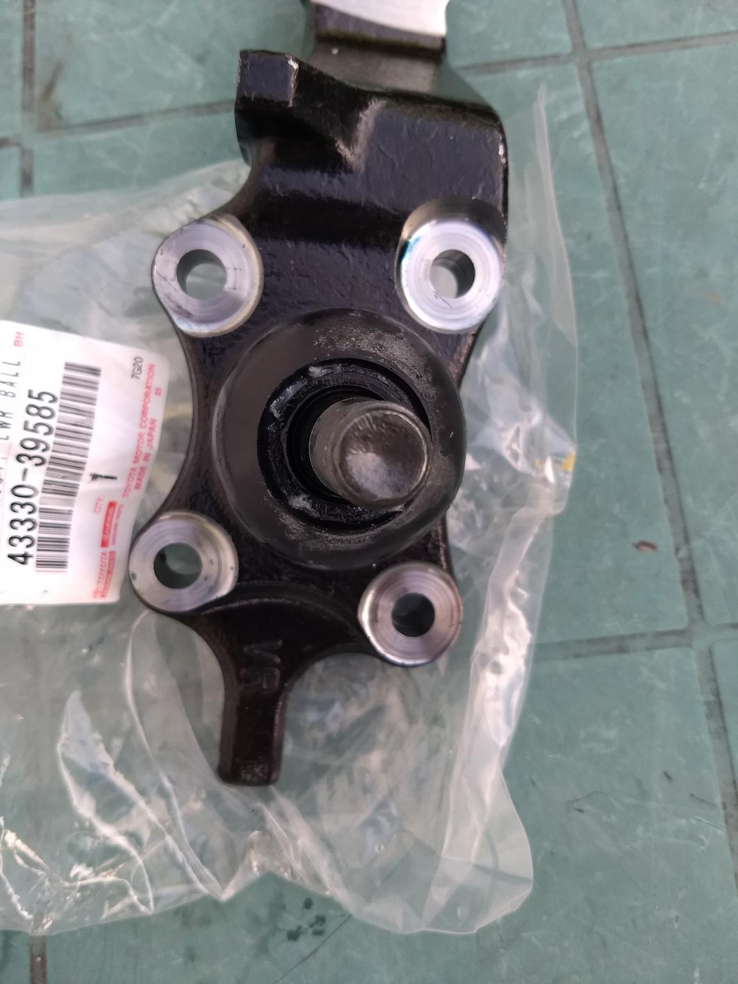

I just received the same ones that Arnezie bought. I usually work on BMW's and they the top of the boots are secured to the ball joint pin to keep the grease in. These are genuine Toyota parts but they are loose fitting at the top of the boot. I assume they will seal when installed but would like others input before I install them.

They will - they squish down and you will be fine.

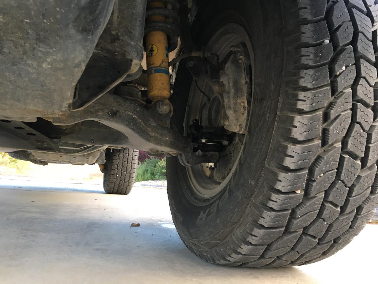

Zoom in on the picture and you can see how they look when installed.
