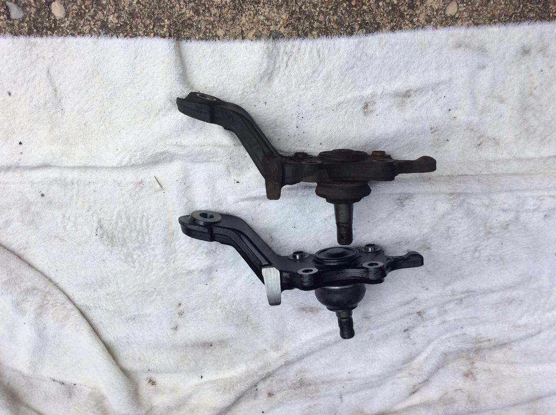

Bingo, 45 minutes.
Done! The ones I took off were in pretty good shape. But at 201k it was worth the peace of mind. You will need a 14, 19 & 21, 24mm sockets and a couple new cotter pins.
