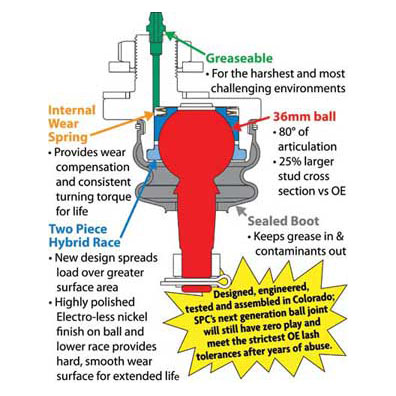

This pic shows info on the newest ball joint design with 80 degrees of articulation. Not sure how this compares to the uniballs, but it's nice having a sealed joint and requires less maintenance than a uniball.

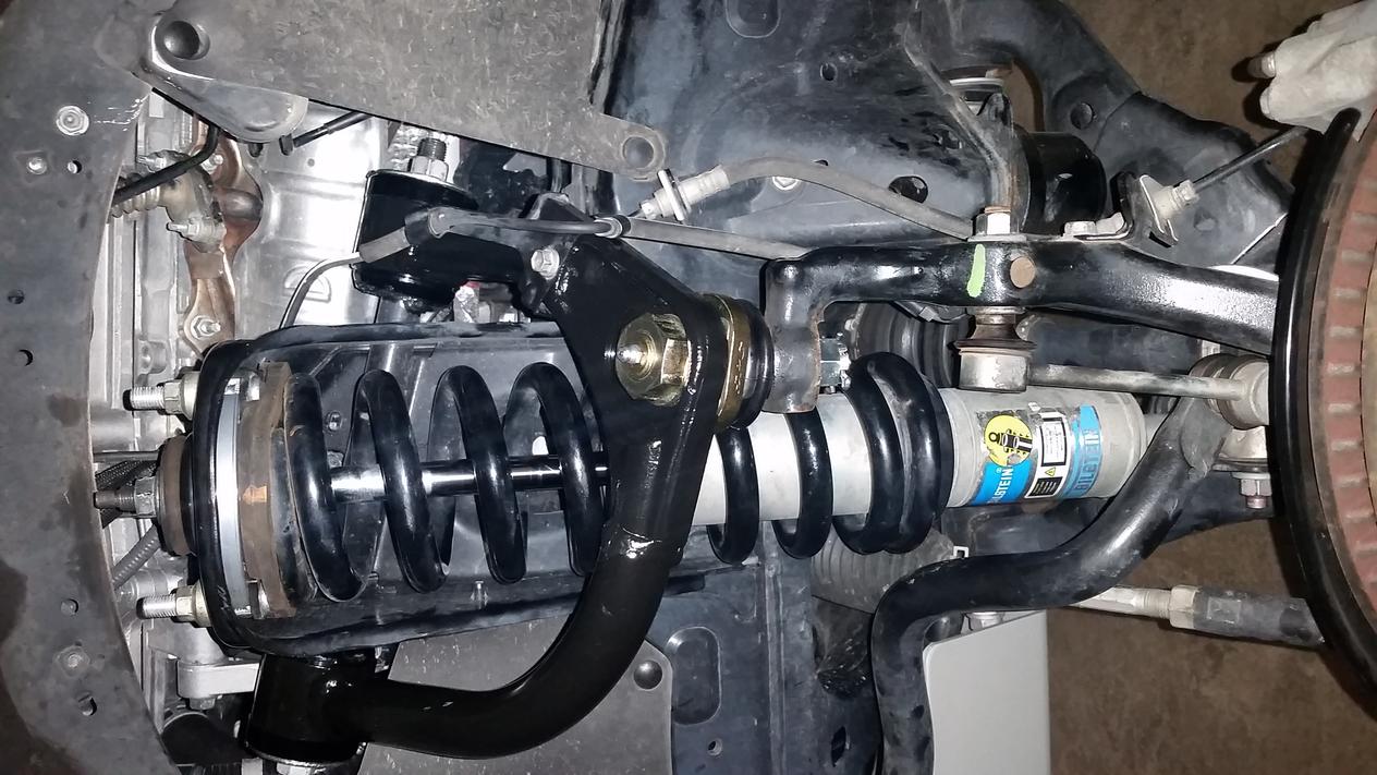

Just installed my SPC tonight. Not sure why pic is sideways.
