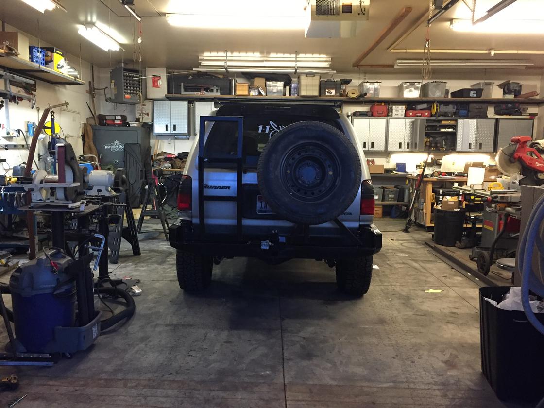

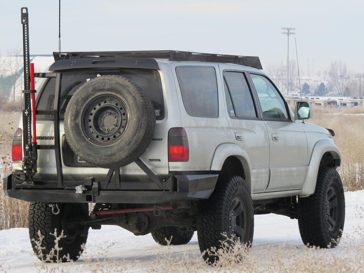

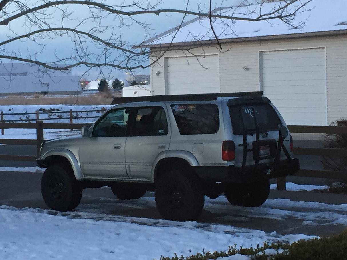

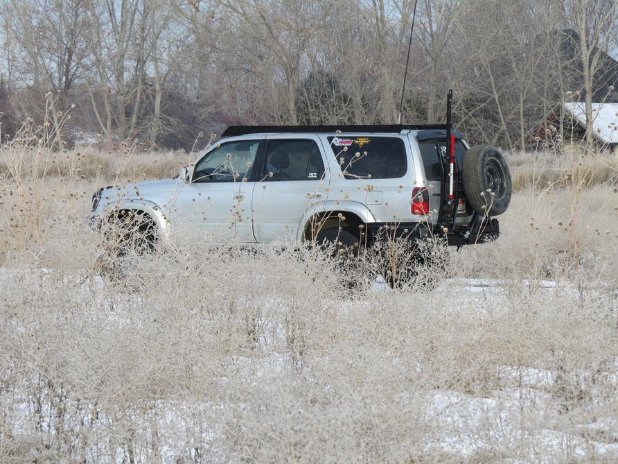

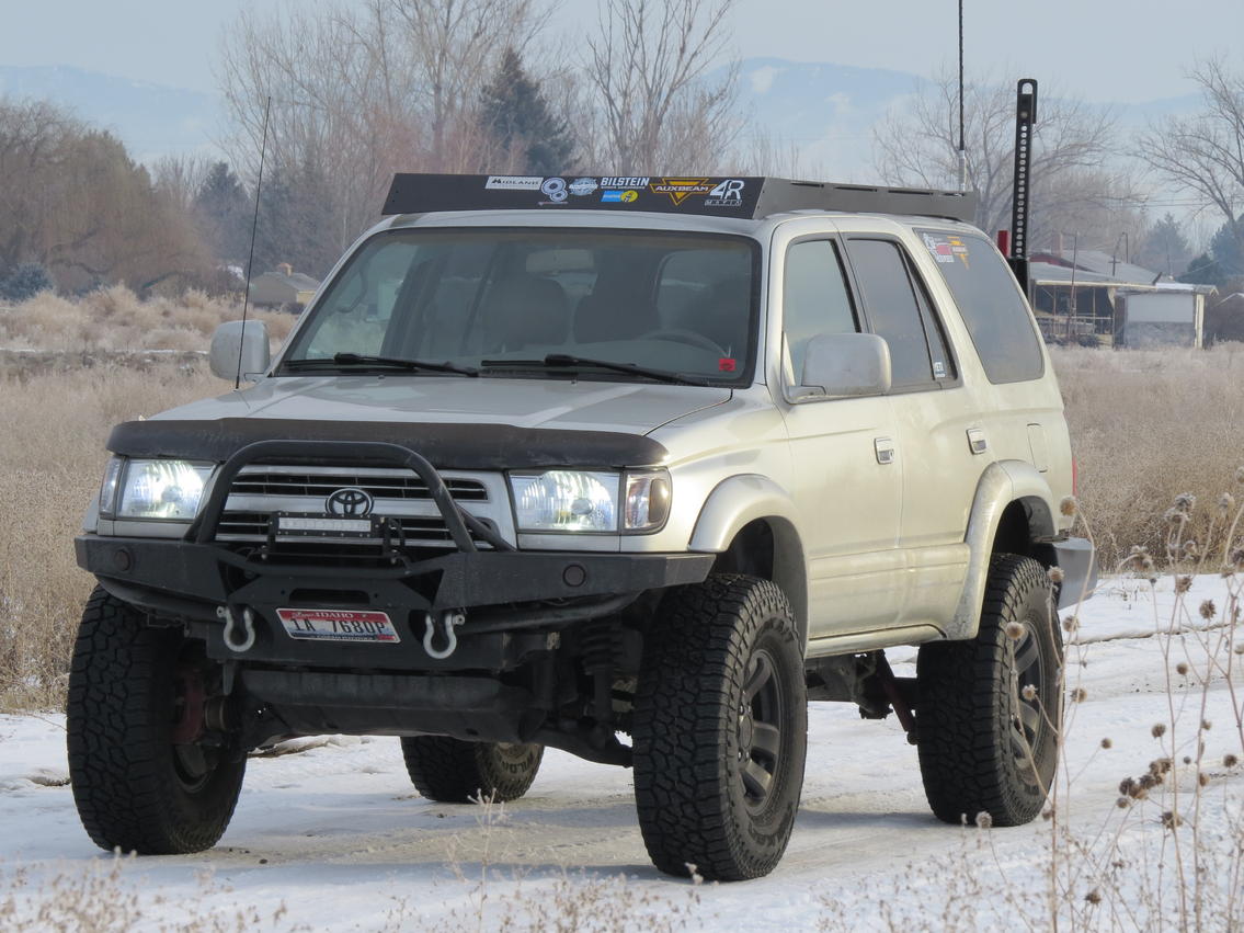

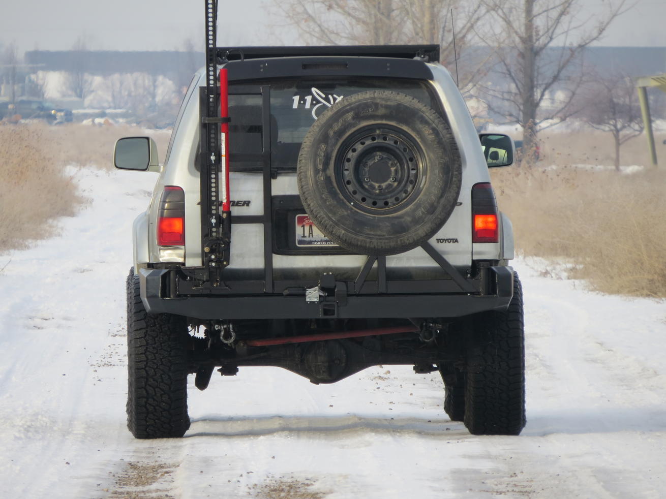

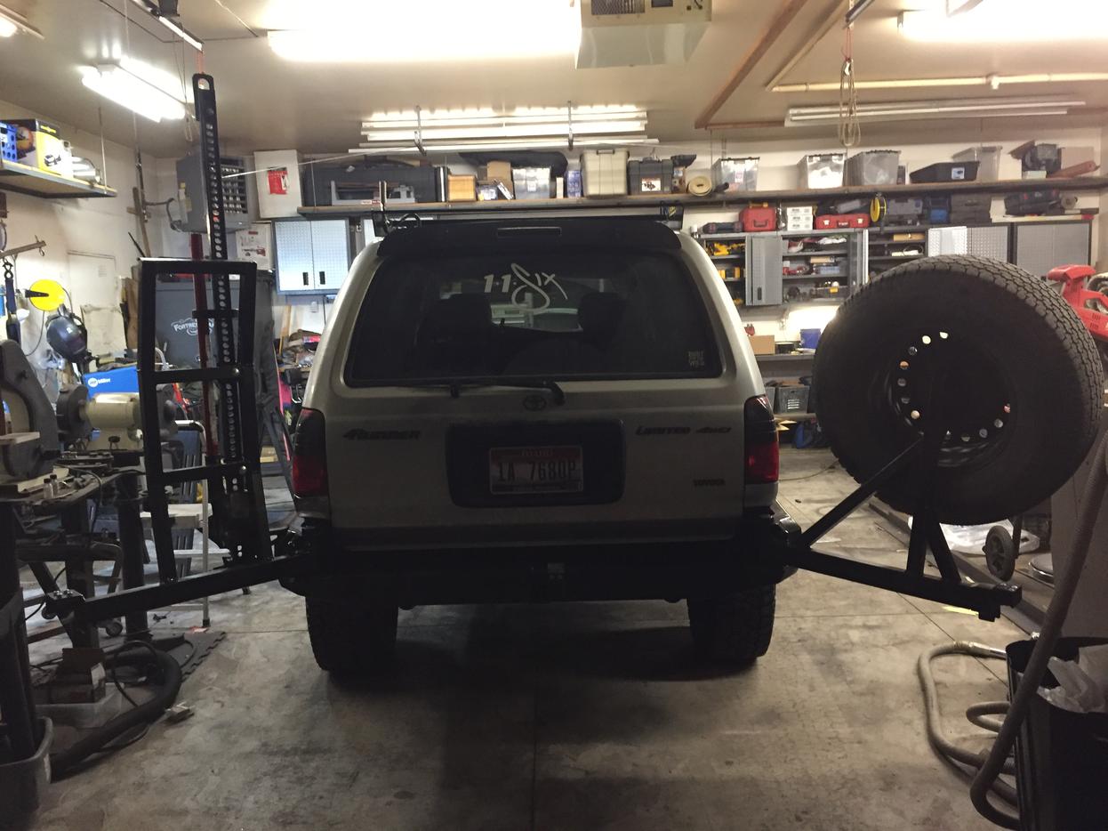

Yesterday I painted it and got it all ready and got it on and today I mounted the tire and hi-lift! Still have more to do but I'm satisfied with how it turned out! The only thing I don't like is the gap, but that will be fixed later. :shrug:
EDIT***HIGHER QUALITY PICS BELOW THIS POST
The Final Costs For this are Below:
Steel(Excluding 3/16" Plate)- $125 (Excluding the parts I rebuilt :lmao: )
3/16" Plate 4'x8'- $175(cut for free by my high school)
McMaster Carr Parts- $115
Bisco Ind. Latch- $80 (It really is completely worth every penny)
Paint- $50
TOTAL: $545 (add a little more for new hardware etc. and remember that we had a lot of the materials/tools that I needed)

That turned out great! The gap is intentional. There should be a 1" vertical gap between the top of the bumper and the truck's body line. This is because the rear of these trucks can flex a lot, and the bumper can hit the body and dent it. When I built my bumper, I only put a 1/2" gap in it, and it dented the body when flexing offroad.
You can easily fill the gap with some soft flexible rubber or weatherstripping.
Get the poly body mounts that Sonoran Steel sells. When I built my bumper there was about 3/8 of a gap and anytime I flexed the suspension it would contact the body. But with those mints it's rock solid and even when I drop the weight of the truck on the bumper there is no contact
I agree. This is a good fix. Unfortunately, this wasn't available way back when I first built my bumper.

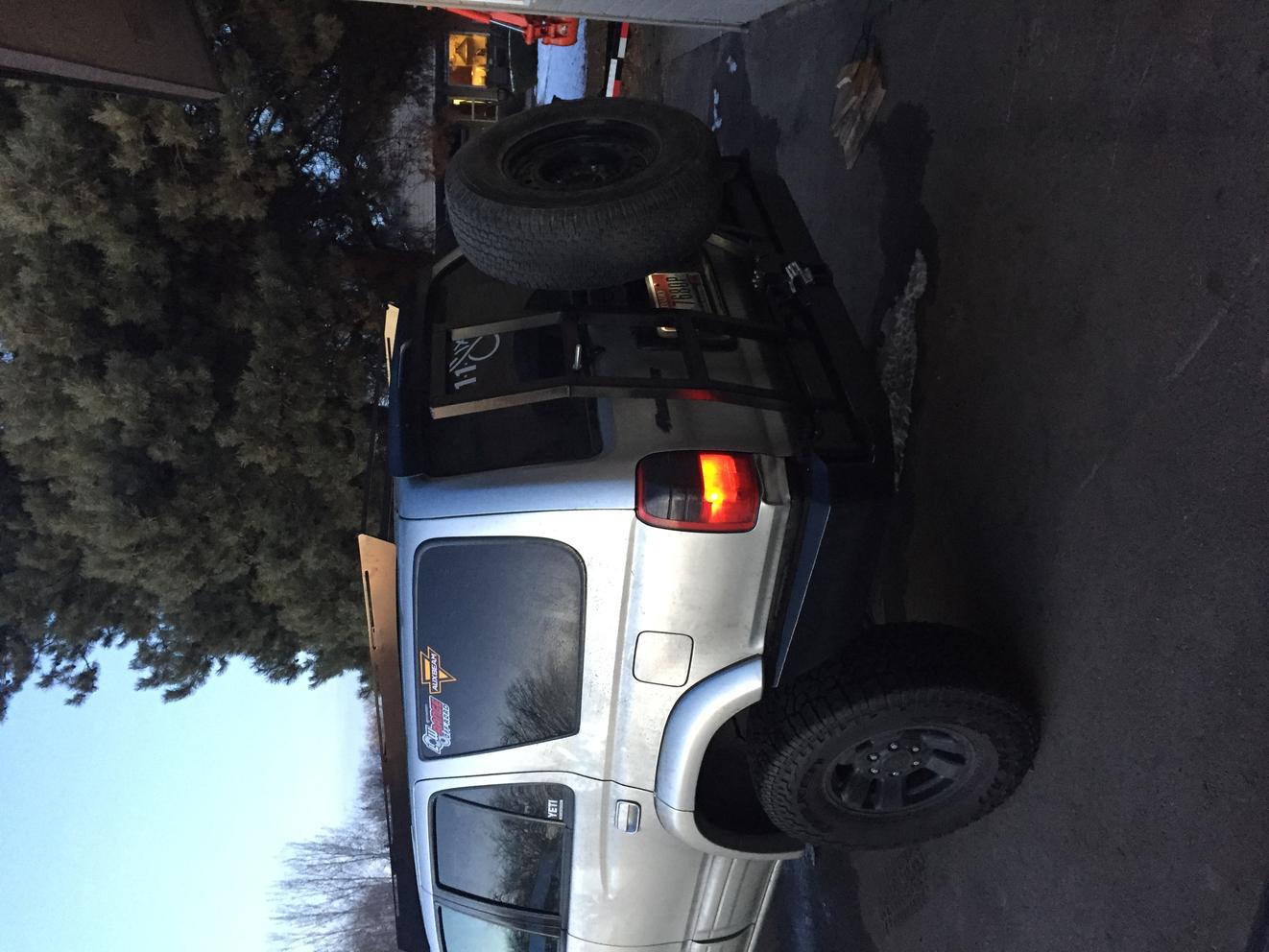

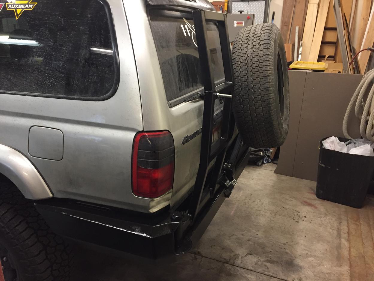

More pictures!
Here’s some more better quality photos!
