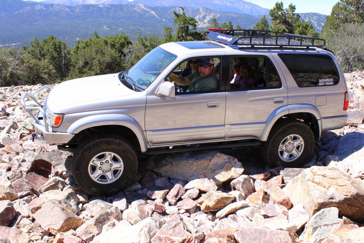

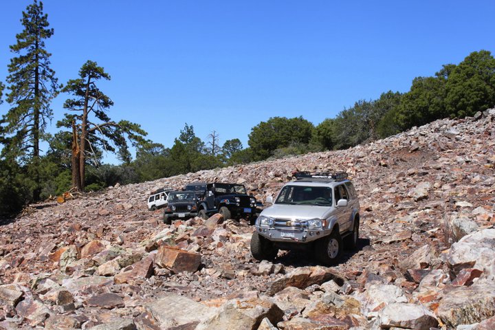

I had my Savage Off-Road sliders installed on Friday and then put them to the test on Saturday. Roy Lewis and his brother are great to work with, he makes a quality product. I pounded them the first day I used them at the Rock Garden on Gold Mtn in Big Bear, CA and they are no worse for the wear! Go with Savage!!!

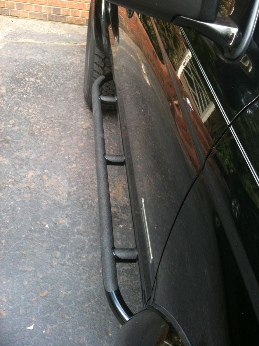

I bought mine from Addicted Offroad, were actually "Trail Gear" sliders they are 67" long and fit perfectly. Made of DOM tubing.
Paid $176.75 shipped to the door.
