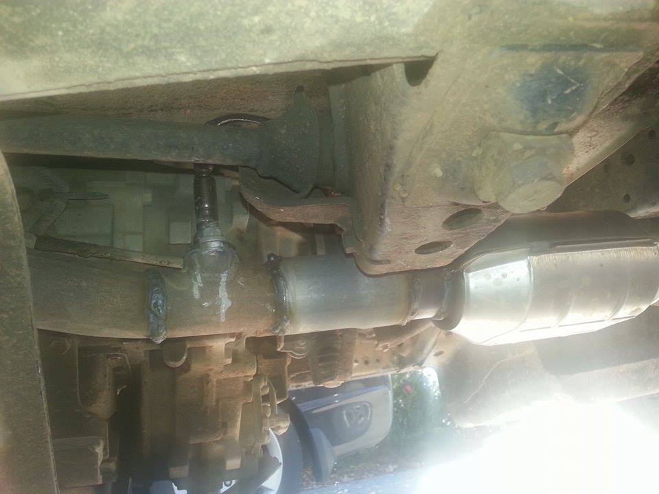

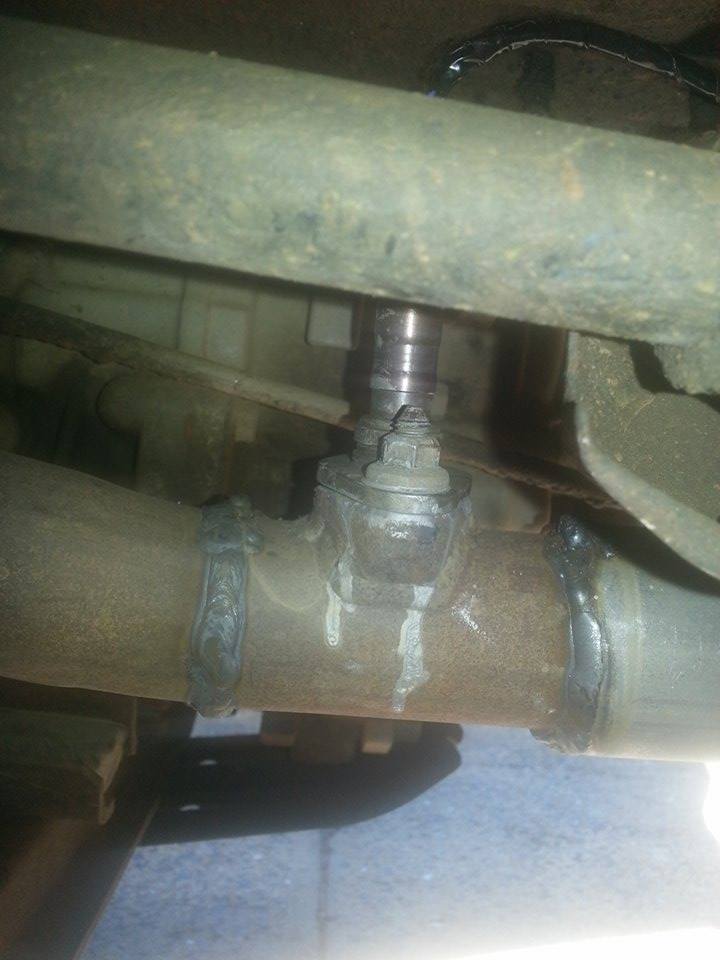

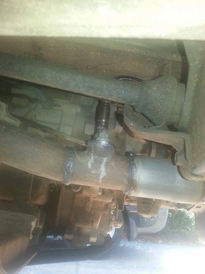

Sooo...they installed the O2 sensor into the manifold? I'm just asking because I can see an exhaust system in my future. The cat thing was stalling me. I guess a competent exhaust shop could weld a bung on a new cat.
I went out and took some pictures for you, hopefully this helps ya. My o2 sensor was so badly rusted on, the shop had to cut it off, and weld it onto a new pipe onto the manifold im guessing.

Thanks for the pictures. I would not have thought of that. I can see that serious off roaders might want to change the location of the O2 sensor due to the dangling wires. On mine they really dangle. I guess I could trim and solder but who cares. Any way it's nice to know I can use a regular cheap cat.
Glad I could help out, and if you're thinking about going with a cheap cat, the flowmaster one I bought off of ebay was 90 something bucks and its pretty good performance and gas mileage wise so far.

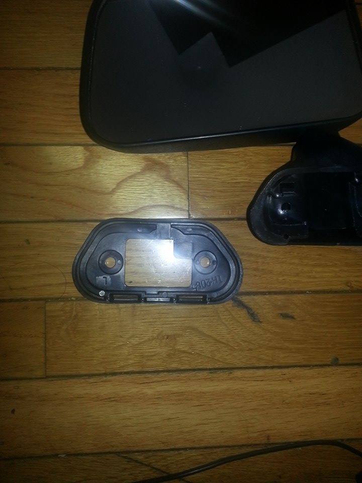

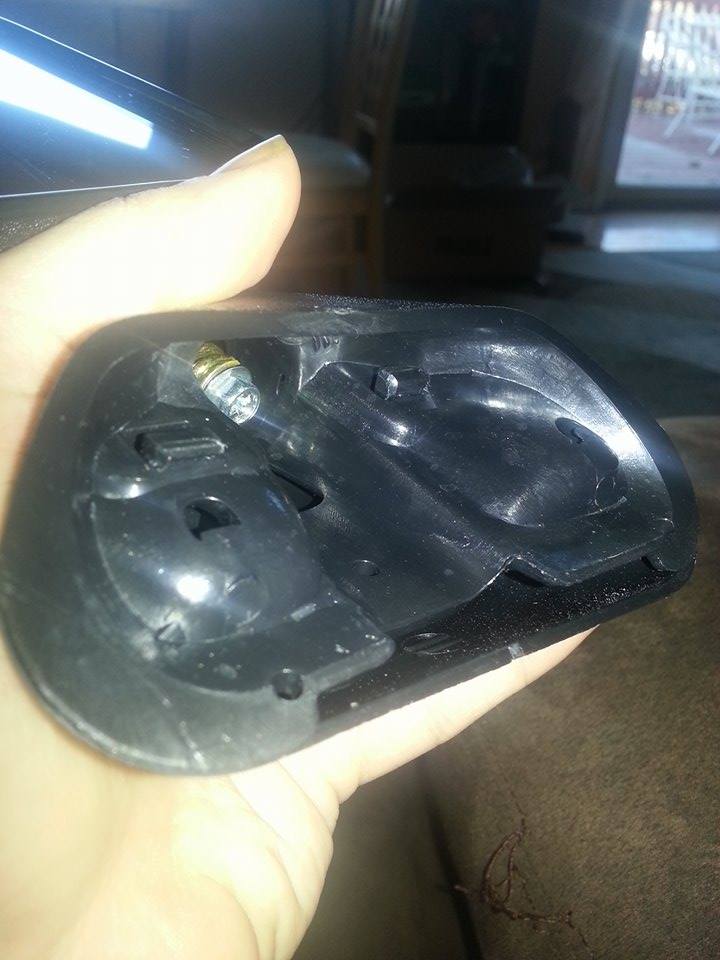

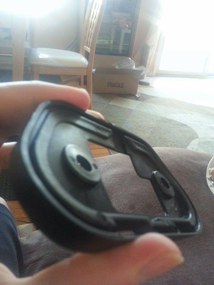

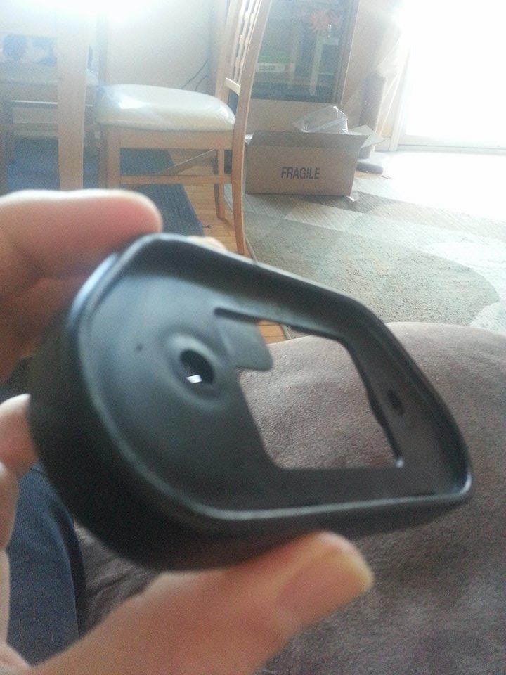

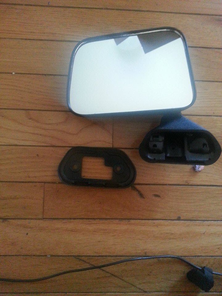

Got my new mirrors in today. But I'm having trouble figuring out how these mirrors are gonna stay on here. Do I bolt up the smooth side or the grooved side with the lettering and numbers? Maybe this would be easier if I had my truck in the driveway to bolt these up on, but its getting a new heater core at the shop smh.
