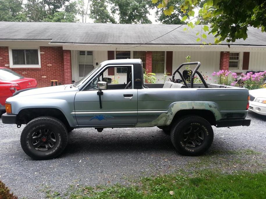

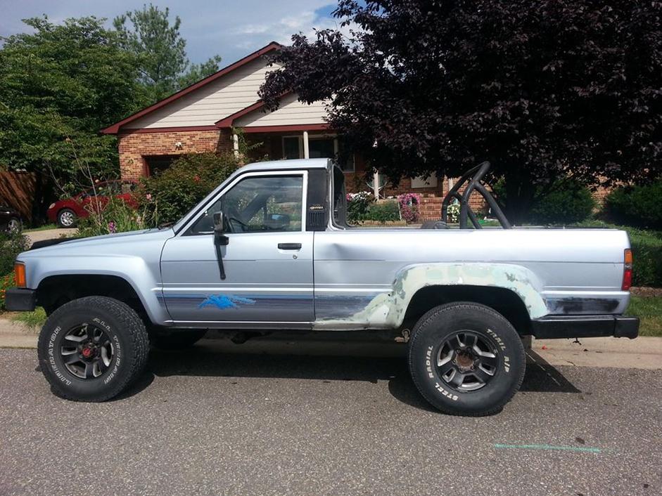

Going topless for the first time and it feels good :party:... but for some reason there is a red light in the dash that says "Back door" any of yal ever get that when you take the top off? but anyways it looks awesome topless, heres some pics

Did you lock the tail gate? On mine if I have the window down, and the tail gate unlocked I get that indicator.
:cowboy:

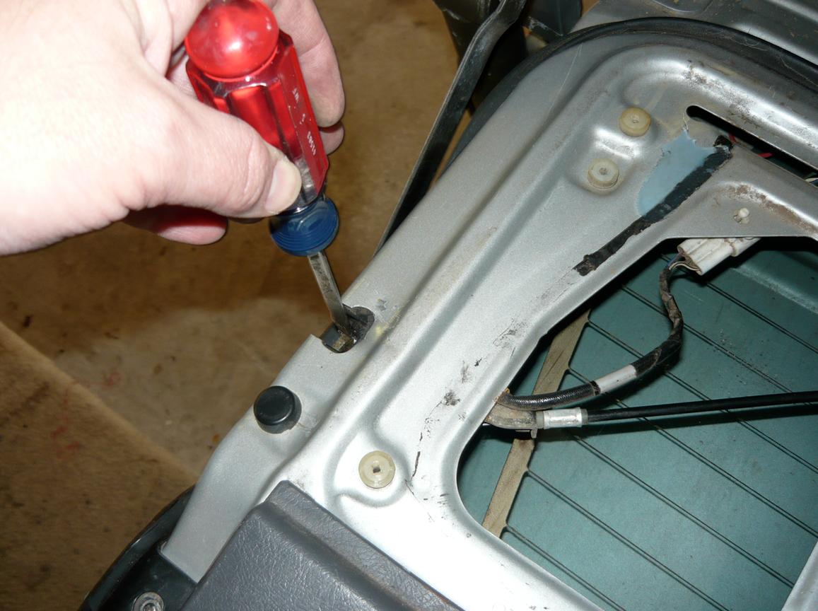

Yep, check to make sure your tailgate (back door) is closed all the way. The switch for the light is actuated thru the driver side latch on the gate. If you closed it and the light is still on, open it up and use a screw driver to work the latch a little to see if it just needs to be freed up.
After that, just follow the wires to the switch and see if you have an issue there.

You'll get the back door light when the tailgate is unlocked. I leave the third bolt from the back on the drivers side in the bed rail so that the rear window still works, and you can bump the window up an inch and it'll automatically lock.
Ya thanks everybody, it was the lock, I pushed it down and the light disappeared. I gotta say I love this truck, the way it feels and drives is awesome, and if everything is fixed up according to plan. I just might sale my 3rd generation and keep this one around permanently @Pisa I actually opened it up and straightened out the dent lol, it was one of those attention grabbing things lol.
