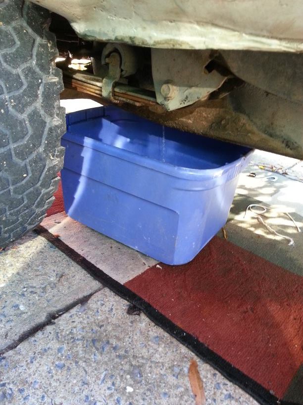

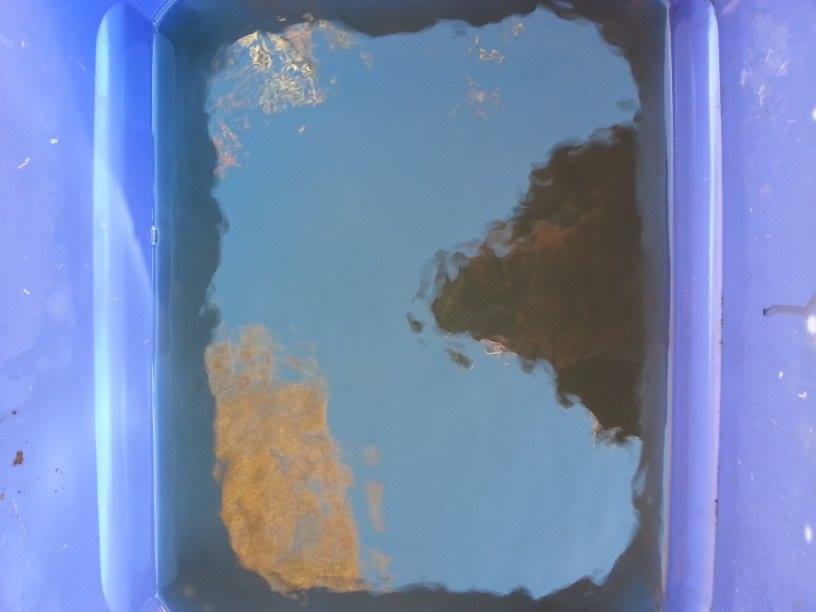

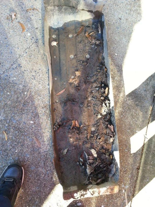

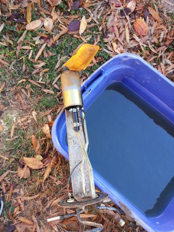

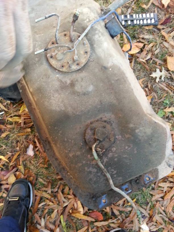

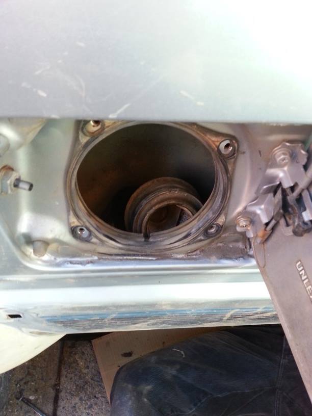

After getting that fuel system cleaner and my truck still performing weird. I finally decided to drop the tank and clean it up. I pulled out the fuel pump no problem but the sending unit would not budge at all, all the screws holding it were rusted out and wouldn't move. But at least I know its my sending unit so I can replace it soon and get my fuel gauge working again. So I finally peeked inside the gas tank and it was so dirty and full of gunk and dirt. I can only imagine all the shaking this tank made on the trail and what on earth it sent into my fuel lines. I scrubbed and cleaned most of it out and put it back onto the truck. I started the truck up and this thing was idling like it wanted to die and it wasnt getting enough gas to it. I drove to the gas station and this thing would not go more then 15-20 mph. I finally made it to the gas station and put some more gas in, I pulled out and right in the middle of the road at a red light my truck died and wouldn't start again. I got help from a few strangers and pushed it off the road. I'm thinking my injectors are all clogged up, what yal think??? heres some pics.

That could be water in the tank from when you cleaned it, that could be a clogged injector, that could be a bad fuel filter, could be lots of things. You could dink around with it and replace this and clean that and maybe get lucky and get her running sooner rather than later, but with winter coming I wouldn't mess around. I'd replace the fuel pump, fuel filter, I'd clean out the tank again and be sure and run a couple bottles of fuel drier on your next full tank, and then you probably ought to yank the upper plenum and pull the injectors and get them cleaned.

I only used fuel to clean the tank not water, I didn't wanna risk it. I also bought a fuel filter but it got dark and I was already 30 minutes late for work so I couldn't hook it up. I was honestly on my way to get some seafoam and run it through the gas tank and crank case but I didn't make it. I think my injectors are completely clogged with the debris that was in the tank. The fuel pump looked like its in fair condition but the sending unit is gone! Pretty soon I'm gonna buy one of those aluminum tanks on ebay for $120 bucks and a new sending unit. For now I just gotta find a cheap way to get my runner home.

I'm gonna check around and see what I can find. I might have no choice but to change the fuel filter on the road to be honest. But I'm almost 90% certain that my injectors are clogged. Because the way the truck was idling it looked like it wasn't getting any fuel at all! I'm not gonna mess with that tank again until I completely replace it. That thing was a pain in the ass to get down and back up.
Well I finally gave in and called my mechanic. He's gonna go pick up the truck tonight and take it to his shop and clean out my injectors. I also told him to install my new fuel filter for me so I don't have to mess with it. I can't wait to get my truck back.
Got a call from my mechanic today and, he told me injector number 3 is misfiring. Looks like thats the next thing on my to do list.
