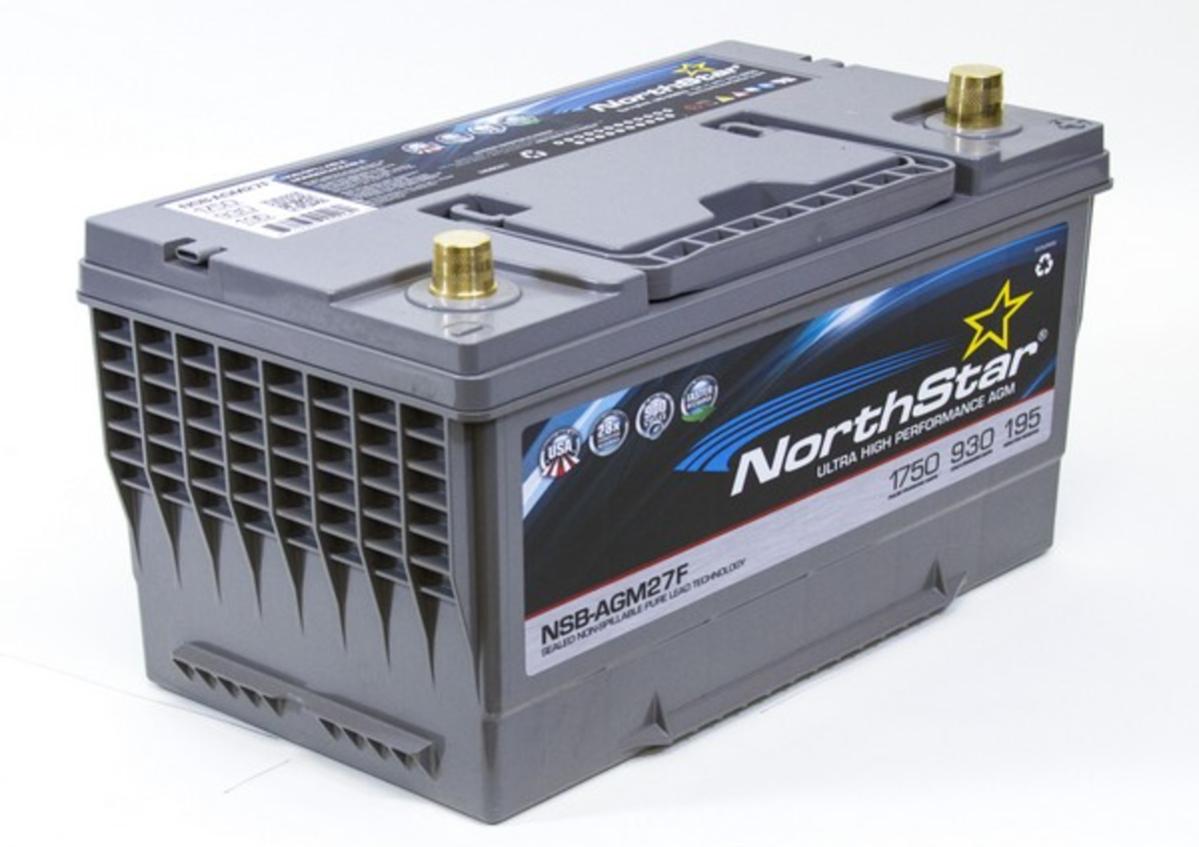

northstar group 27 will fit without mod, I use 31 but its modify a little to fit, I took off the negative terminal since its too high for the hood to close.
