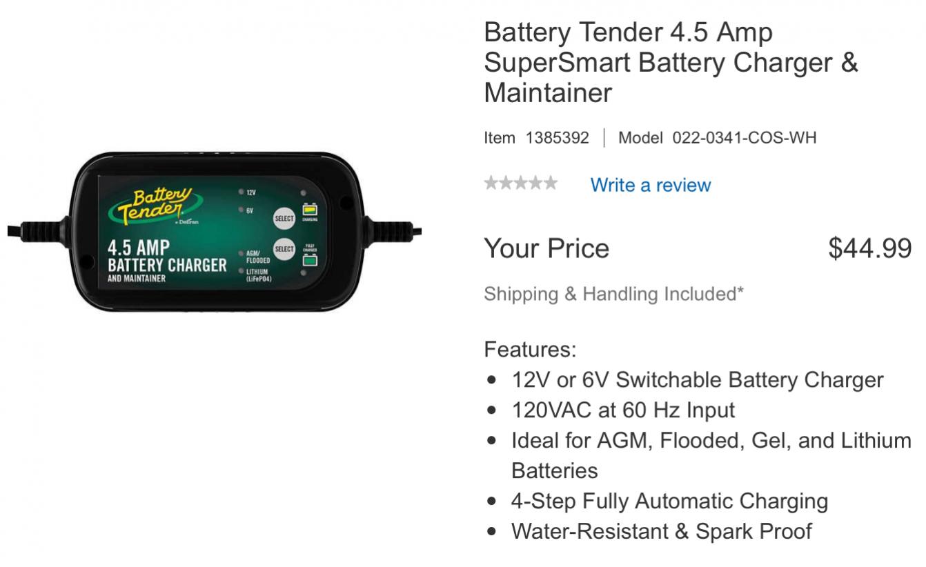

For cars that you don’t drive often, or store for extended periods, try out a battery tender. I got a good 4.5 amp model from Costco For less than $50. Installed permanently, and plugged in when I anticipate using the truck.
Costco has them on sale as of Nov 2020 for $36.

NP. BTW, I just went by Costco the other day and the 4.5 amp trickle charger/maintainer is down to $36.
