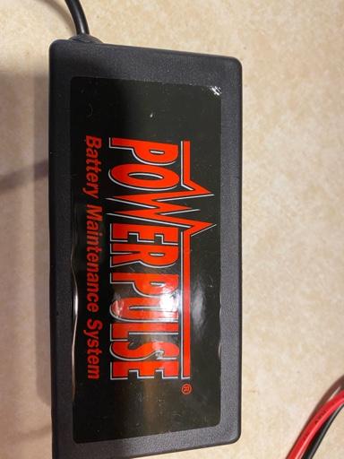

How often do you drive it?
Does it ever go dead between driving?
If you don’t keep the battery above 80% charge by driving it at least 20 miles one day a week, or keep a tender on it. Your battery is doomed to fail.
This is what I have on all my rigs.
