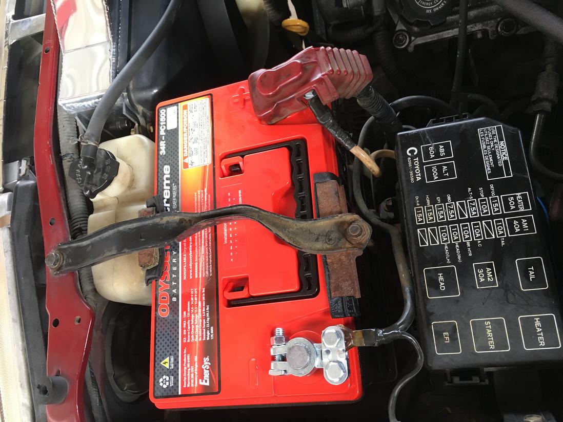

Odyssey 34r all the way. I have one in my 08 Tundra that's 8 years old and cranks it like new. 880 CCA. I just put one in my 1996 4Runner. Be sure and get the $8 height adapter if you go this route. It was around $250. If you are interested I can look back and see where I ordered it from after shopping around for the best price.
That's the battery I'll end up with once my current one dies. Pricey but worth it. Any issues with the spacer adapter sliding around when wheeling? I was gonna fab a higher mount but if there spacer works without shifting I'd use it.
It snaps on tight. Hasn't moved on me at all so far. The wife's GX460 is getting one next.
