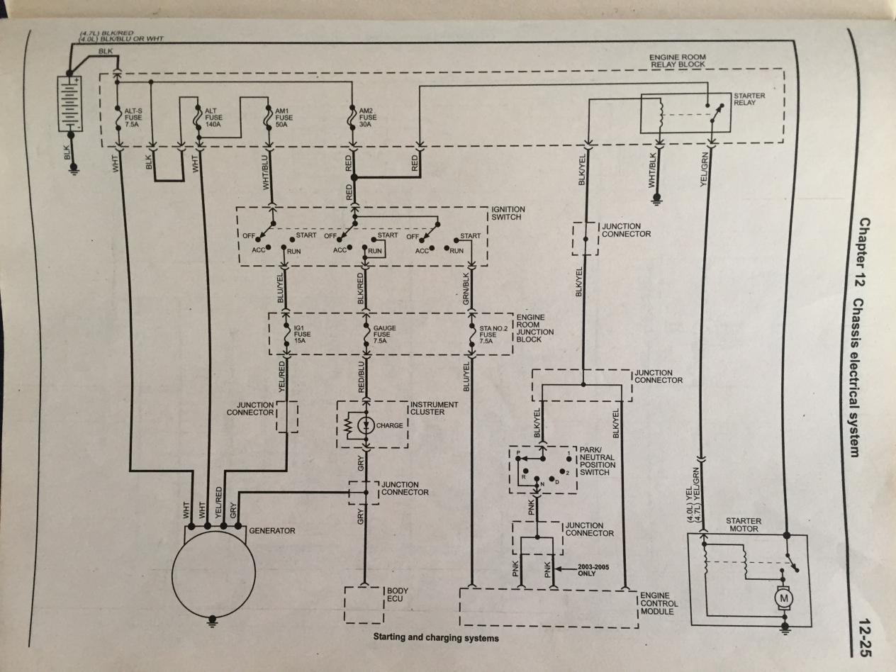

Attached is the circuit diagram from my Haynes manual. Any more ideas are much appreciated.

I would check to see if you're getting approx 13-14 volts on the gray wire coming from the alternator to the junction block. That wire should provide opposing voltage to the charge light. It has battery voltage coming from the fuse. If it has battery voltage coming from the alternator, the opposing voltage will not allow the current to flow and thus the lamp will be off.
Thank you, this is exactly what I was trying to look up, what that grey wire should normally read. I'll check the gray wire voltage.
Do you have any tips on how to measure voltage at the gray wire on the alternator? It seems like the only way is to unplug the 3-wire connector at the alternator then measure voltage on the alternator pin. But I'm not sure if running the engine with the 3 wires unplugged from the alternator is ok?

The Battery light is supposed to come on when you turn the key on because the Gauge fuse is sending power to the light and it is grounded in the voltage regulator inside the alternator. When the engine starts and the Alternator is charging, the voltage regulator sends output voltage back to the light, which turns off the light since it no longer has ground. if you could back probe the gray wire on the alternator plug, you should see alternator voltage when it is running, if not, the internal voltage regulator is bad. Which in essence means replacing the alternator unless you are crazy, like me.
