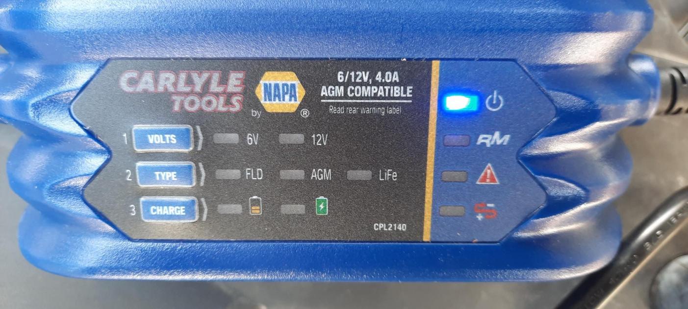

Thank you! Could you recommend a good battery maintainer? I picked this one up at my local NAPA for $50 as it was recommended by the guy working there. But I can return it if you have a better one?
As long as its description is "smart charger" where it goes thru several stages of charging, desulfation, trickle, ect. it will do fine. Not sure if they make batt last longer but it will work better while it does!
