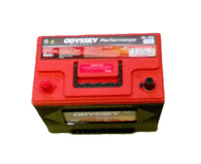

Okay, so the R stands for reverse terminal layout and is a standardized part code for "group 34" batteries, as well as all the other "group" battery specs. If you look at my battery, the positive terminal is on the left at the top of the battery, it is a group 34R. This is a group 34 NOT R battery:
As you can see, positive is on the wrong side! In case you wanted to know what the other letters mean in the Odyssey-side of the part number, here ya go:

This battery fit nicely in my vehicle, I used a ¼" pvc spacer (from one of my sign board scraps) at the top just to make sure it was super tight when bolted down If you look at Odyssey's website, it clearly states you may need a height adapter, I decided to just make a spacer for the bracket and let the battery sit flush on its tray.
I did not have to change the cables at all, (I think I bent one of them also like someone else previously stated in this thread), and they are not extended either.
