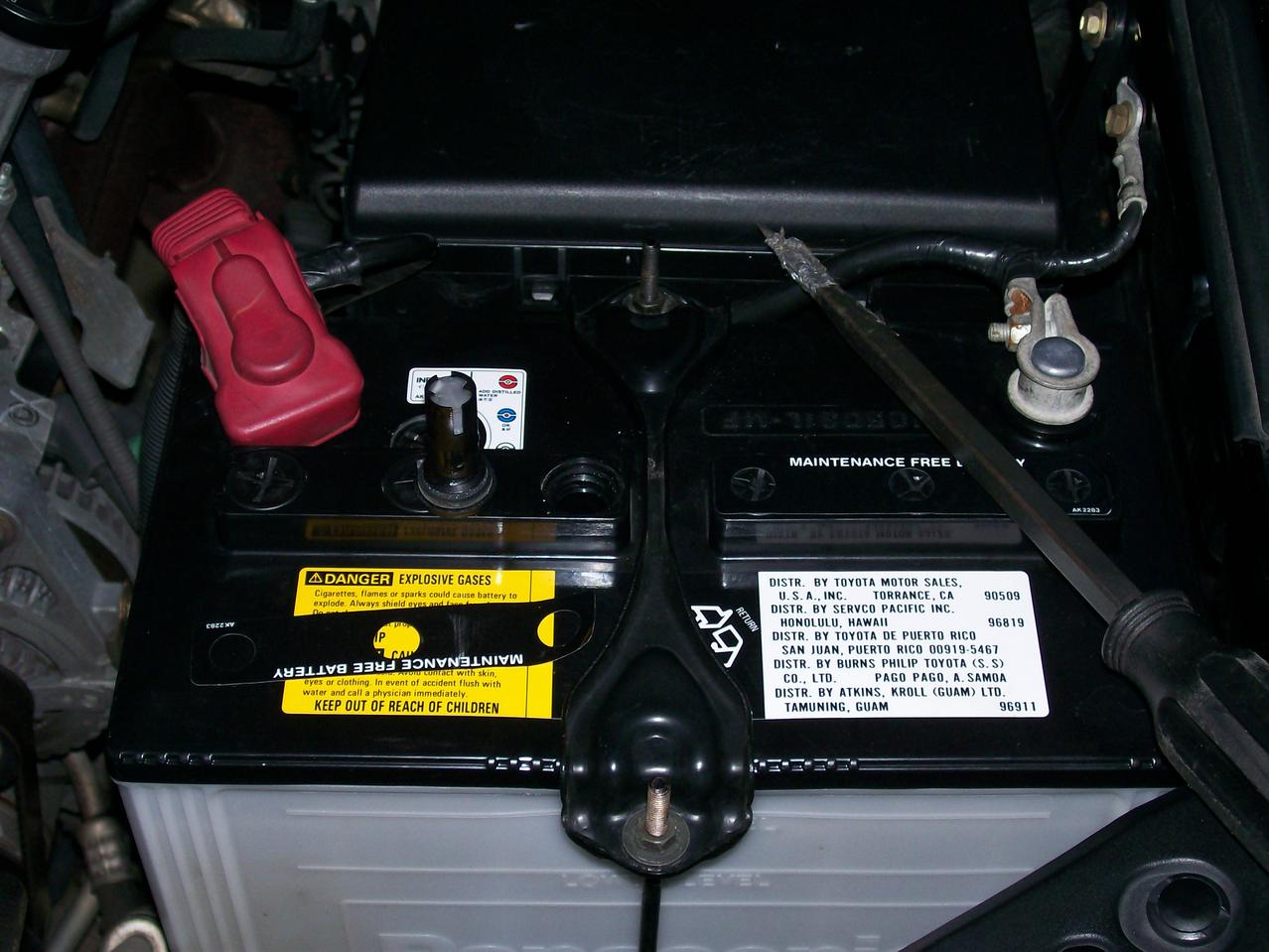

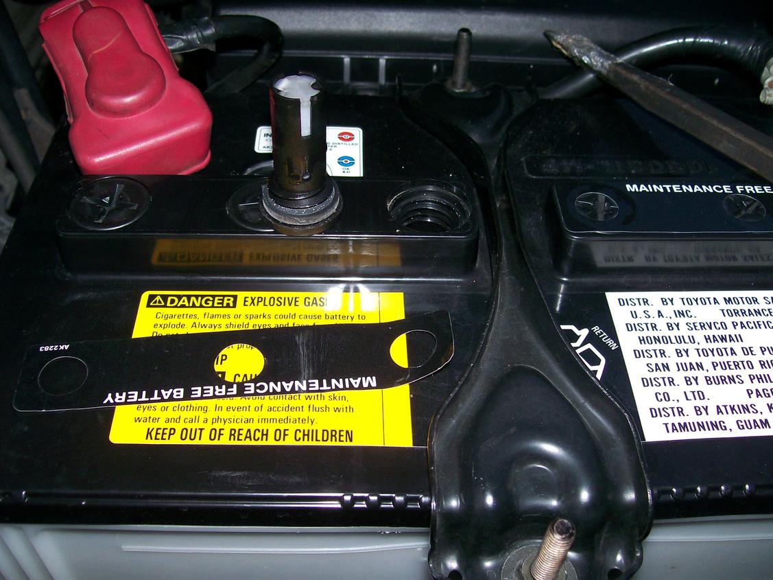

If it is the factory panasonic battery it can be opened. I have done it. it is not completely sealed. The circle caps can be screwed with a large flat blade screwdriver without damaging the battery on the newer batteries. It will open 1 cell with each cap. They are a VRLA battery. Valve Regulated Lead Acid.
The older panasonic battery had a rectanglar cap that opened 3 cells at a time.

As posted above, I just topped off the water in my battery. The key is peeling off the "Maintenance Free Battery" sticker shown in the pics.
