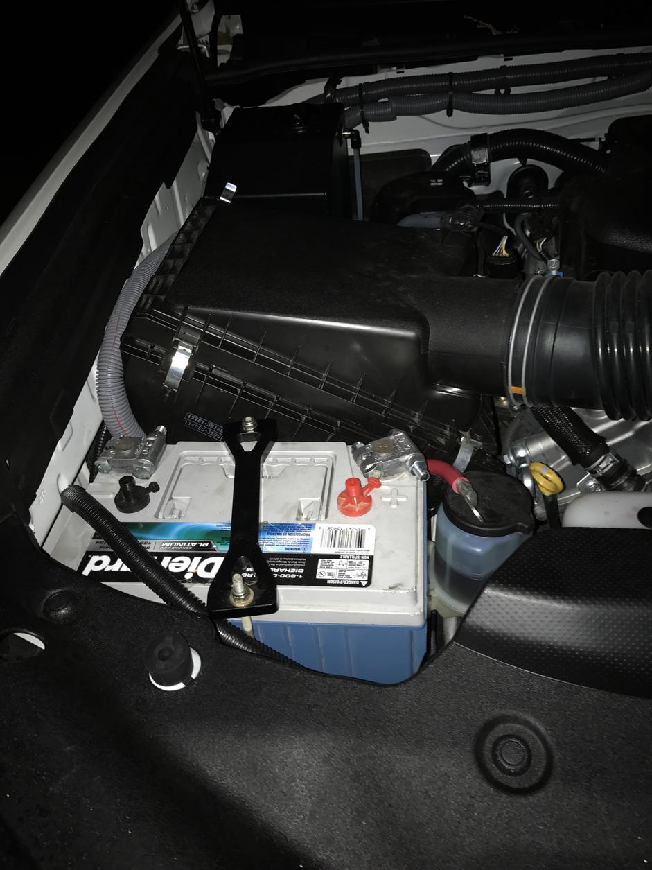

I'm running a die hard platinum 34m which I believe is identical in dimension.. I can't check measurements now but it fits fine. Perhaps compare the dimensions you have with the sears variabts? Old photo I dug up here when I was in the process of wiring everything up. Hope this helps.

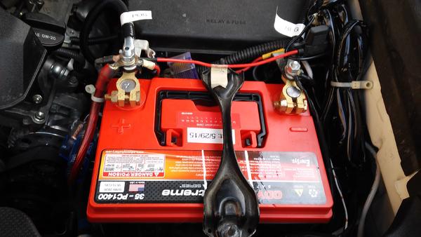

Tag. I just put an Odyssey 25 PC1400 into a shrockworks tray as my dual battery, I'd love a group 34 Odyssey in that location. If someone finds out it fits, I'd love to know. I'll move my 25 to the starting battery and get a 34 for the Aux.
That Diehard does look like it might be the same battery. I'll see what I can dig up.
That definitely sounds like the Odyssey.... those are as close to identical specs as you can get.

ETA: [MENTION=96425]JSparky[/MENTION] --- can you see if your truck has a piece of curved metal that sort of wraps over that front corner of the battery. The corner where the last "d" in Diehard is pointing to. If the frame is the same that corner should be tucked up under arc of metal.
If it is, then I think I'm going to start looking for a sale price on a 1500.
Ya I'll see what I can do, I'm laid up with a broken leg right now. I may be able to get my brother to take some photos showing that corner for you.
