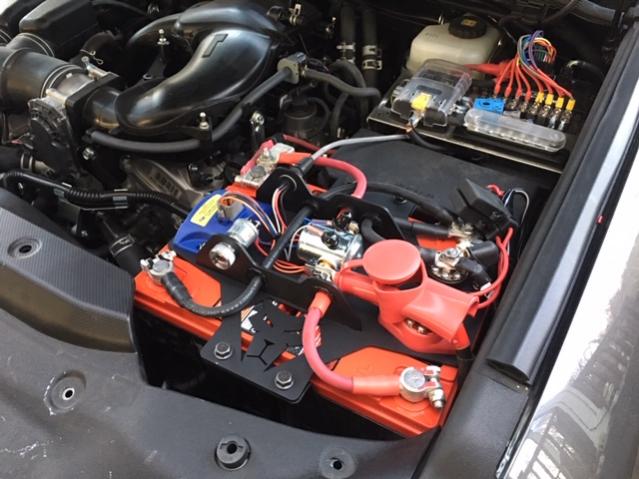

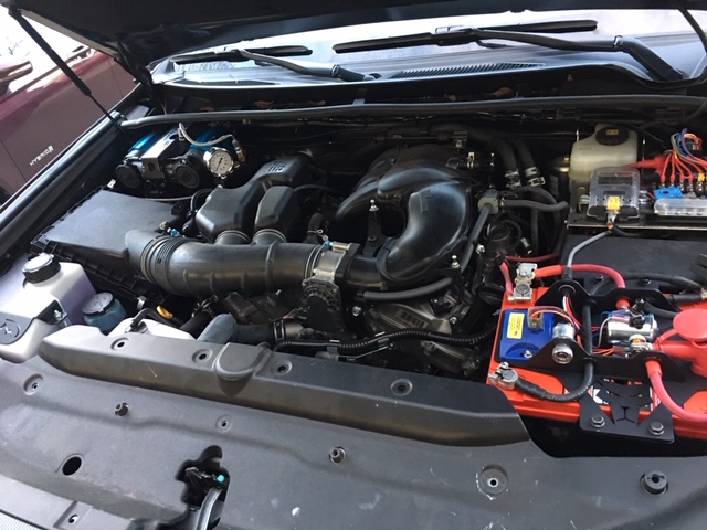

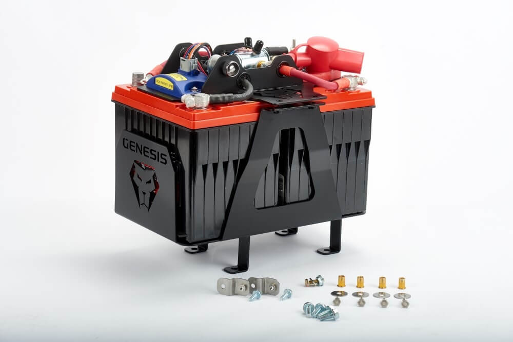

I have accessories mounted in all 3 of the other corners under the hood so I went with the Genesis dual battery system in the stock location. Its a smart system that makes sure the cranking battery is charged enough( at 13.7V for 2 minutes) then automatically connects the aux battery and starts charging both at same time.
And If I remember right if it sees the cranking battery drop below 12.7v while vehicle is off it disconnects them automatically to save it for cranking later. Seems like a pretty good kit. It uses two Odysee extreme group 25 batteries.
I got the optional G-screen too which I mounted on my dash so I can see the voltage of each battery and manually connect them or disconnect them at any time
Genesis Offroad Toyota 4Runner Dual Battery Kit

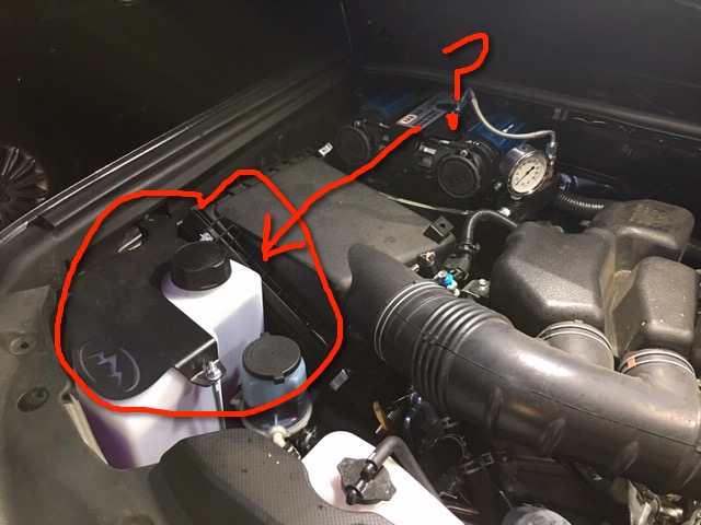

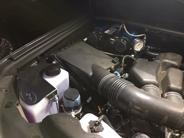

[MENTION=216234]57buick[/MENTION] - I'm almost afraid to ask....but what is in the passenger side front corner? That seems like a WHOLE LOTTA WIPER FLUID..........How often do you need 2 gallons of 20/10?

Thats the expedition One washer bottle kit. both front and rear come out of the same bottle and yes I use it alot on dusty forest roads and such and bugs lol

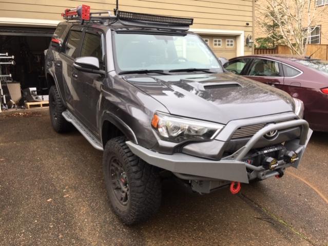

That was done because the factory one stuck out the front like sore thumb after installing the addicted offroad bumper and was prone to getting punctured by a rock or stick when off roading thus why Expedition One created that kit...for aftermarket bumpers
