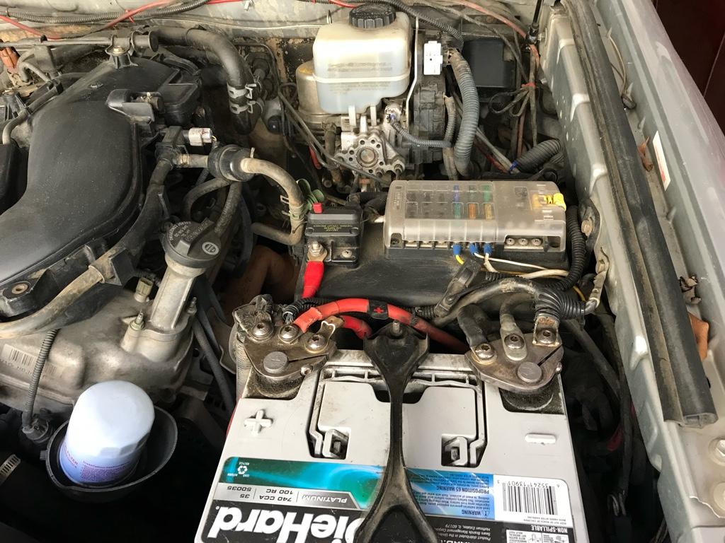

My 2016 SR5 is now a Die Hard machine. I installed it's 1st battery.
Die Hard GOLD 24F-6.
750 Cold Cranking Amp baby.
Original tray and battery clamps fit perfectly for the install. Now it starts like a champ.
