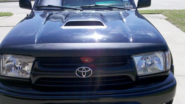

Here are the steps I went through to do the front part of my hood after I taped off the area:
1. Scuffed it really good with a rough sandpaper and then went over it with a finer grit (300-600) and then again with a 1000 grit.
2. Cleaned it really well with a dish-washing detergent to remove any oils/etc that were left over.
3. Wore rubber/latex free gloves throughout the process to prevent putting back any oils from my hands.
4. Sprayed on a light coat of Rustoleum Bedliner and let it dry at least 30 minutes. Then sprayed the second coat a little heavier.
It seems to be holding up really well. I am doing another section of the roof near my sunroof now but haven't sprayed it yet. I am learning that prep takes the longest time but makes the job easier and better looking. I do agree with the kid that primer shouldn't have been used originally but since you did just scuff it really, really good. The first light coat will act as a primer of sorts for the heavier coat/s.
DUUDDE That looks great on your hood. I wanna do my rocker wall...but im just a little afraid to take sandpaper to the body of my car...

Hey thanks. Don't be afraid. I am doing a section of the roof in the front too. The spray on makes it easy to cover up mistakes. PM me a reminder and I will send you pics once I am done. Don't want to Hijack this thread.
