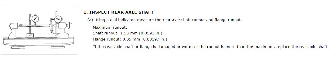

I assume bent axle means bent axle, not bent axle housing. A bent housing would cause problems - brake noise would not be one of them. Bent axle shaft would cause the brake rotor to wobble and almost certainly a leak of gear lube. You would feel that immediately the first time you stepped on the brakes. The rear tire would also wobble on the road. You would also have grease on the inside of the rear tire/wheel on that side.
I'm having a pretty hard time believing your mechanic that a squeaky brake is the result of a bent axle or axle shaft. Pulsating brakes at least would be consistent with a bent axle shaft. Squeaky brakes is not a consistent symptom in my mind. I would get a second opinion on it - or just check yourself.
i've seen them bent at the flange and not leak, but you were still able to feel the vibration
did your mechanic check the runout or pull the axle, how did he decide on the axle being bent?
I have to agree with Jetboy -- seems like if you'd had a bent axle for 6 months, there'd be a lot more symptoms than just a squeaky brake.
Three courses of action I'd consider: 1) Get a second opinion; 2) Ask your mechanic to show you how he diagnosed a bent axle; 3) Heck, if lubing everything up made the symptoms go away for 6 months, I'd consider just doing the same thing every 6 months until I got rid of the truck ;)
Yep, lots to check. If it is bent at the flange, just throw an axle in it and be done. It does seem odd though. Check runout on the rotor then they need to remove the rotor and check runout on the flange itself. it may just be something wrong with the rotor. Or just swap rotors from left to right and see if the problem moves. Same could be done for the axle shaft themselves if you want to get down to it.
sounds like a warped rotor to me..I would want run out proven to me. However, it may be a PITA to press out and disassemble enough.
Someone may have slid it into a curb.... and bent the rim.. but surprised it would not be leaking at the seal and vibrating.
