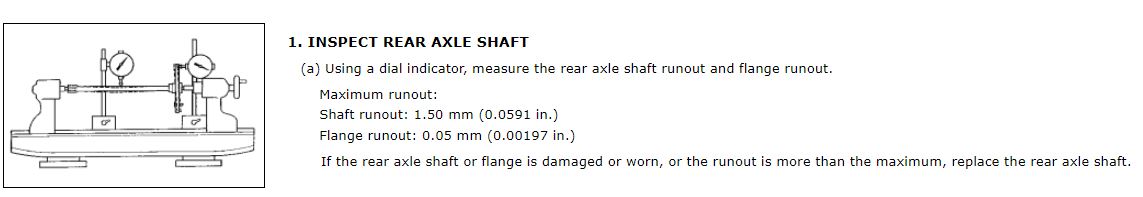

If it was measured at 0.1mm runout then this would be close to double the allowable per the manual. It is a ridiculously small tolerance.
With 0.05mm runout on a 6.5" flange it would be at a 0.017° angle. With 0.1mm of runout it would increase to .0347°.

According to the 4runner service manual from Toyota. The maximum rear axle shaft runout is 1.50mm and the rear axle flange runout is 0.05mm.

There are other options to fix this besides replacing the axle like machining the rotor to account for runout. There are also shims, not sure I would trust them. Both would be more of a bandaid to the actual problem.
To be super clear, your slightly bent axle flange is causing everything mounted to it to also have runout i.e. your rotor and wheel / tire. As your tilted rotor spins it makes the contact surface between the pads and rotor not parallel and dynamic (squeaky). Your wheel & tire are also wobbling although you are not feeling that.
The more runout the more it will reduce your brakes performance, eat up your pads / tires and make noise. We are speculating you are double the allowed.
I think the tolerance is ridiculous and would have thought the caliper could account for some minor misalignment issues but we are talking about high speed rotating parts that need to be parallel to other surfaces to function.
