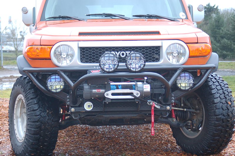

I like the look of metaltechs wire grating they use to hide some of the UGLY. They don't make a bumper for the 4runner but I'm planning to copy their fjcruiser bumper design and use the grating to hide the ugly along with black paint.
see pic below
